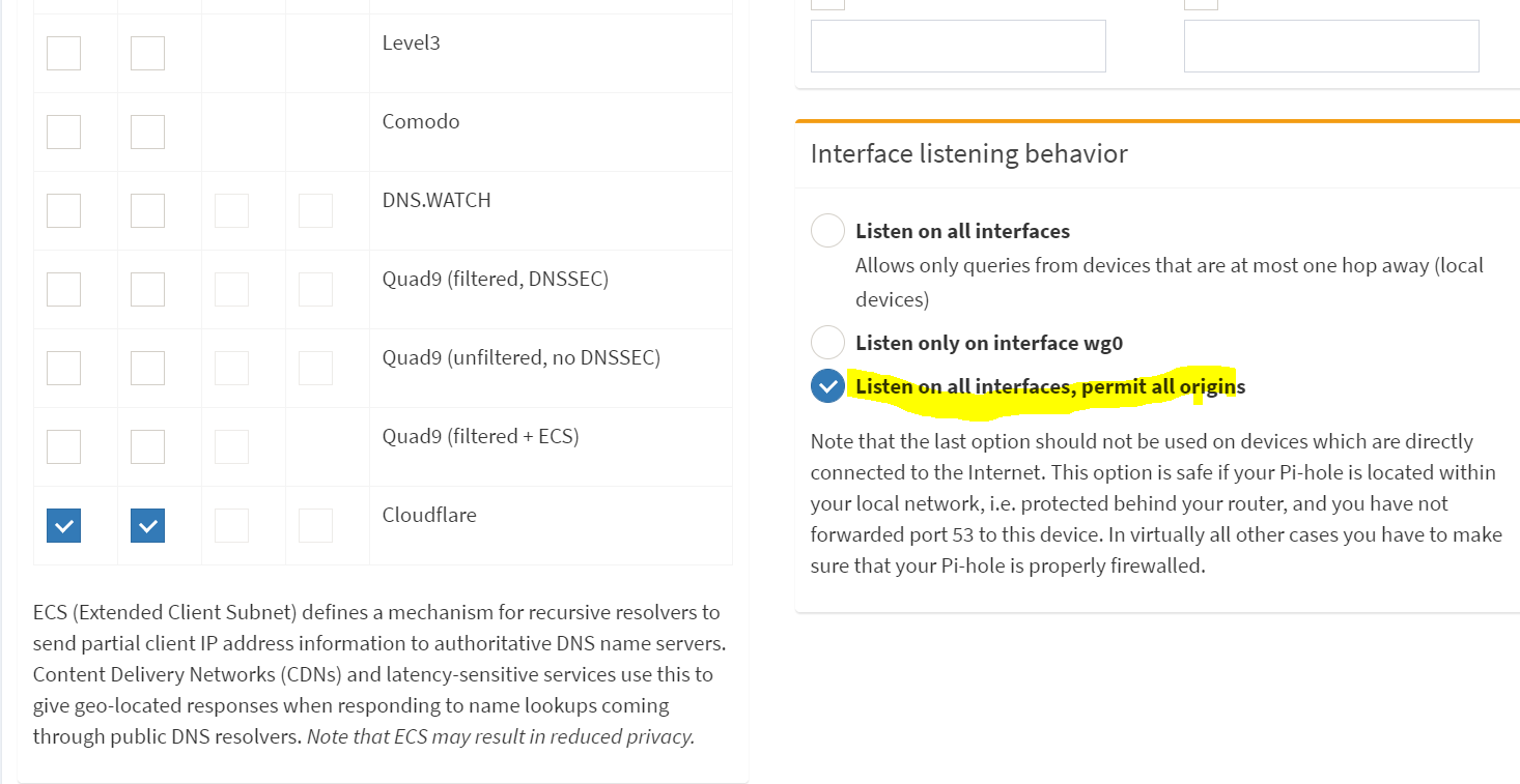

In general, you should stick with the recommendation of whatever guide you've used, but one quick thing you could try is to see whether switching Pi-hole's Interface listening behavior under Settings | DNS would make a difference for you.

Got it to work with the help of guy who wrote the how-to!
My problem was that the port was not forwarded and DNS needed to be changed to 10.7.0.1
client.conf need to be updated to the following:
[Interface]
Address = 10.7.0.2/24
DNS = 10.7.0.1
PrivateKey = 4P1AacAvZY1hLqxqimiCxKK4Bwxl8Hu1B363mXXXXX
[Peer]
PublicKey = MYKEYHERE
PresharedKey = 0EoTIV1xuU5nmLiMP/Glxd+BkdkYrhHJ1A1XXXXX
AllowedIPs = 0.0.0.0/0, ::/0
Endpoint = MyPublicIP:51820
PersistentKeepalive = 25
Hope it helps someone!
