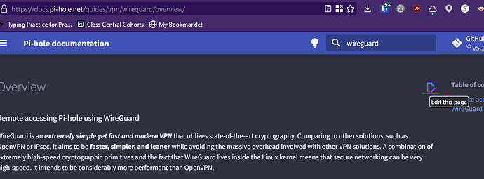

You can edit the documentation files to add anything that was missed or could be updated, if you are so inclined. The documentation will be seen by far more users than just a note here on Discourse.
Thanks. Happy to create a pull request.
https://github.com/pi-hole/docs/pull/964
