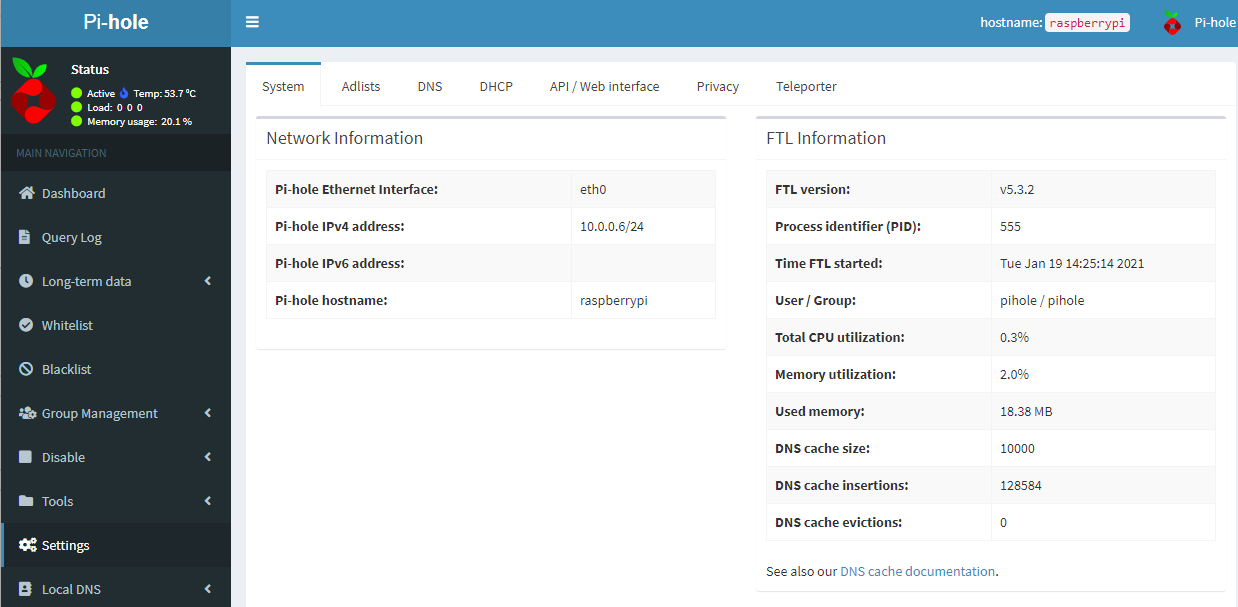

DanSchaper, I usually use the GUI interface with the Pi. I think the version info you're looking for is here:
10.0.0.1 is my router (Netgear Orbi) and it looks like it's been set as the DHCP Server since I set this up:
