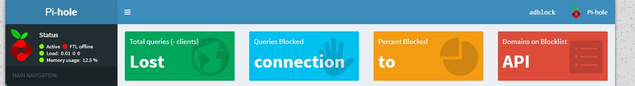

I'm a little concerned that my dashboard is all spinning circles like it's trying to query data. Did the pihole -r command basically wipe those stats?
Flush your browser cache and reload. Sometimes the browser cache is out of sync with the log data since the log data has changed.
I get this?
Let's clear up the API then look at your IP addresses again.

Here's both results.
sudo systemctl status pihole-FTL.service
pihole-FTL.service - LSB: pihole-FTL daemon
   Loaded: loaded (/etc/init.d/pihole-FTL; bad; vendor preset: enabled)
   Active: active (exited) since Fri 2018-07-27 11:35:25 CDT; 2 days ago
  Process: 1217 ExecStart=/etc/init.d/pihole-FTL start (code=exited, status=0/SUCCESS)
    Tasks: 0
   Memory: 0B
      CPU: 0
Jul 27 11:35:25 adblock systemd[1]: Starting LSB: pihole-FTL daemon...
Jul 27 11:35:25 adblock pihole-FTL[1217]: Not running
Jul 27 11:35:25 adblock su[1273]: Successful su for pihole by root
Jul 27 11:35:25 adblock su[1273]: + ??? root:pihole
Jul 27 11:35:25 adblock su[1273]: pam_unix(su:session): session opened for user pihole by (uid=0)
Jul 27 11:35:25 adblock pihole-FTL[1217]: FTL started!
Jul 27 11:35:25 adblock systemd[1]: Started LSB: pihole-FTL daemon.
