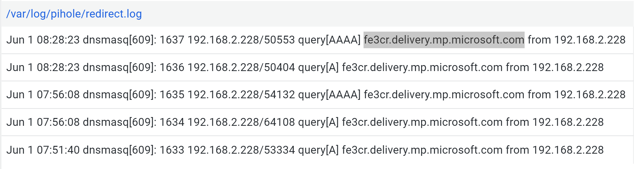

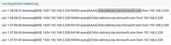

In order to get a clear picture of the culprits, I've added something to my pihole to be able to log these redirections, full manual (how to) here (pfsense + pihole-FTL + dnsmasq).
Looks like it works, the devices mentioned above all try to bypass pihole, the queries are logged (by the additional dnsmasq - NOT listening on port 53) and eventually replied to by pihole.
Today, however (192.168.2.228 is a windows 10 laptop):

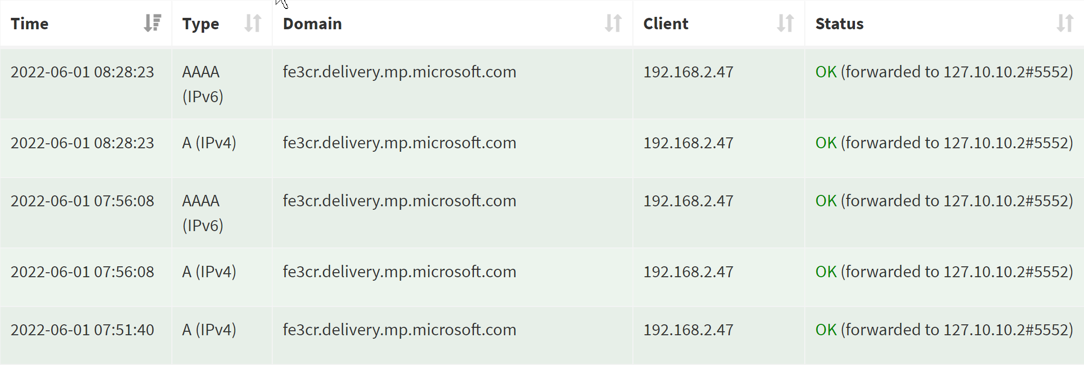

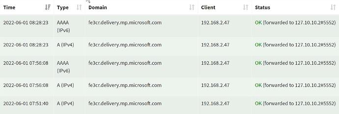

thus redirected to pihole (all redirected requests arrive from the secondary IP address 192.168.2.47)
I checked, before today, all the requests for the domain fe3cr.delivery.mp.microsoft.com went straight to pihole (no attempt to bypass), however, as of this morning, these queries (only for the above mentioned domain) attempted to bypass pihole.

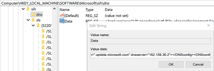

Hmm, are you running an enterprise Windows on that laptop?
Sorry I can't be too specific as I do not run Win10 personally, but I think that looks similar to the default fallback DNS server configured by Windows group policies in case Windows has difficulties contacting the Windows update server.
I can't name a source, but there should be a registry key pointing to that specific address. Overwriting its value should address your issue, but I wouldn't expect that registry entry on Windows consumer editions.
found a registry key containing the IP address
that contains, among a lot of other XML info, a string:
ID="DNSResiliency-CloudFlare-Live"
This fallback must of been activated by something, no idea why, I haven't noticed any pihole DNS delays or problems...
