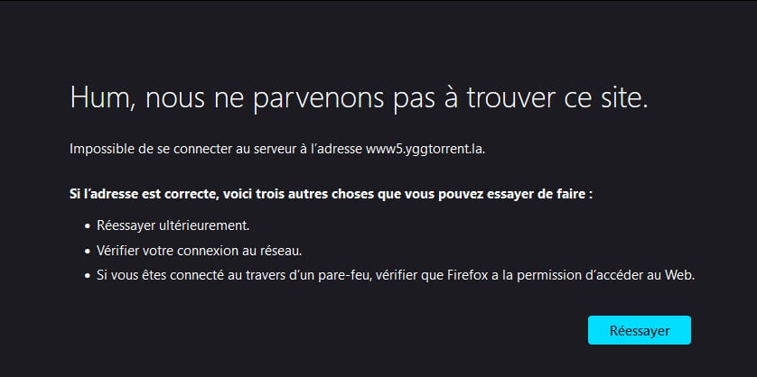

Some sites are blocked (not blocked when i use linux machine). Even some local website only accessible on my lan are blocked.

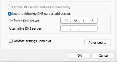

I've set the pihole IP as primary DNS in the settings of my ethernet connection, restart my machine, then it worked only for few minutes. After couple of minutes, the sites are being block again.

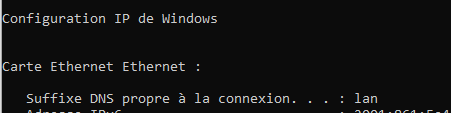

here is the result of my ipconfig

Your IP Config Picture seems to be cut off....
What are the websites being blocked? Can you see the sites in your PiHole query log being blocked?
You mention "local website only accessible on my lan are blocked." which would be odd if Pihole was blocking them unless you have set something within the blacklists, How do you access the local website via name or IP? What is the error the browser shows while attempting to access the website, DNS related?
Have you gone into your ethernet adapter IPv4 Properties and set your static Pihole Address there?

The DNS server section of ipconfig /all should reveal which DNS server addresses your Win10 is using.
Yess i can see them in the logs.
Sometimes by ip or sometimes by FQDN.
yes i've done it this way !
it shows 2 ip : the first one is an ipv4 (my pihole IP actually) and the second one is an ipv6 (i don't know where it belongs to).

I suspect that IPv6 to belong to your router, and if so, your IPv6-capable clients may choose to use it at their own leisure, by-passing Pi-hole completely.
Check that IPv6 against IPv6 addresses of your Pi-hole host machine.
Those can be listed e.g. by
ip -6 address
I've just checked and you're right. The ipv6 from my pihole machine isn't the one i saw in DNS Server section of ipconfig /all.
And i've double checked by going into my ISP router interface and i saw that the ipv6 there was exactly the same as the one of ipconfig /all.
So i guess i need to add also pihole ipv6 to my windows network configuration, to force windows to use this adress ? (actually i've already done it for ipv4)
