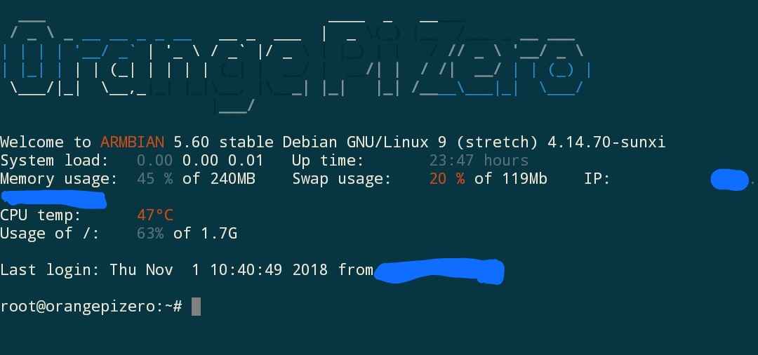

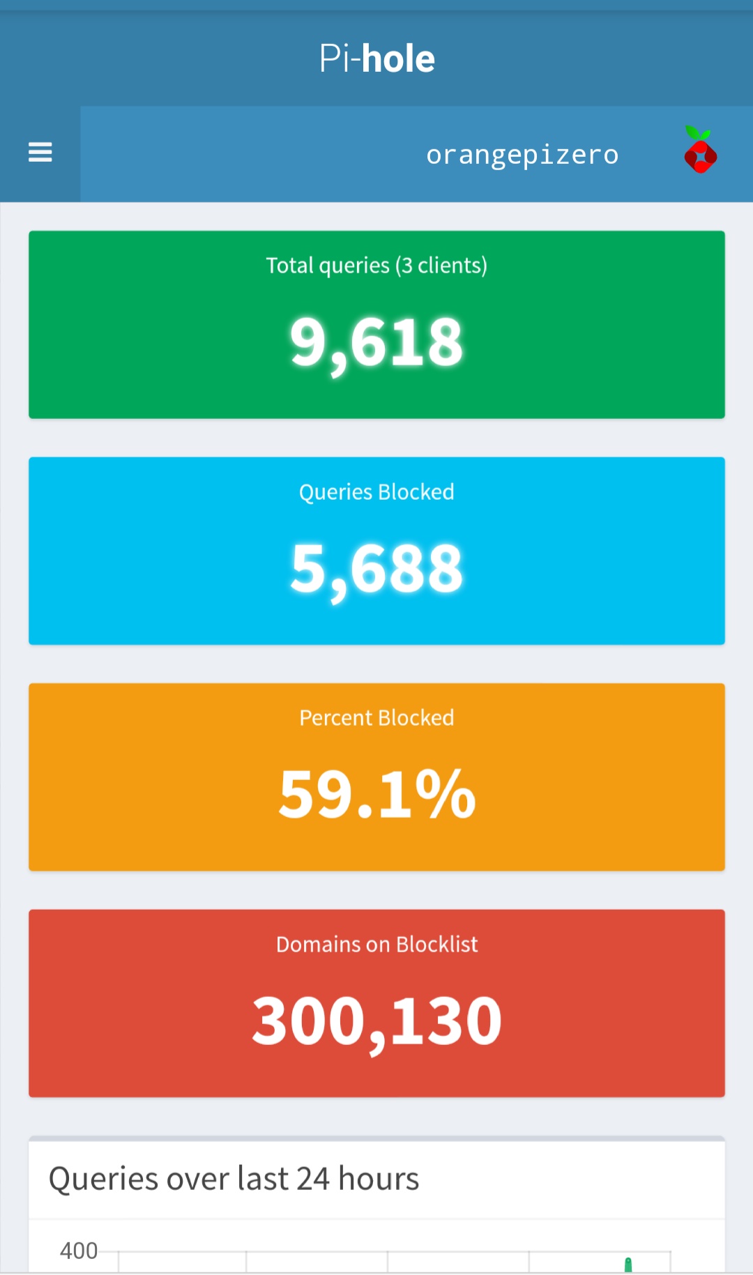

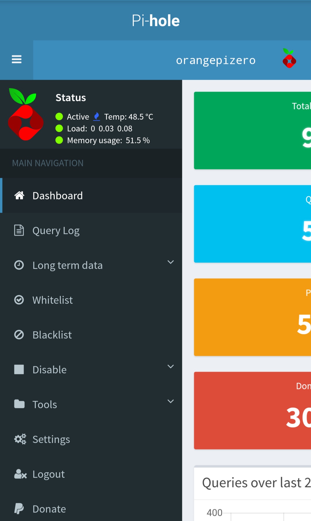

Update!
Run very well even with 300k of list!! RAM don't even reach 50%!
I'm using a very old 2Gb class 4 micro SD card just for testing but it turn out to be running just fine so I'm stick with it.
