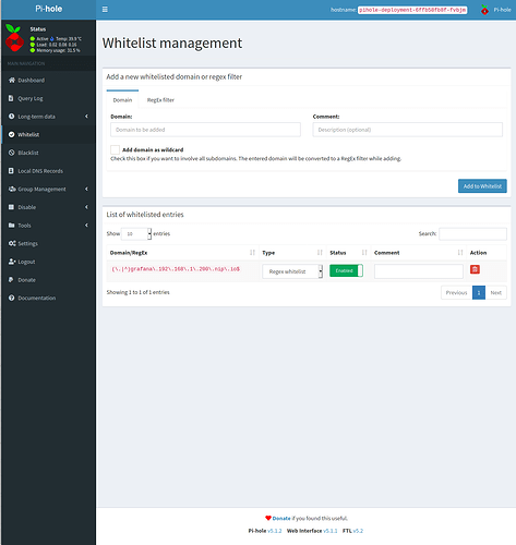

I have a Grafana install, together with Prometheus which should be accessible over a wildcard domain.

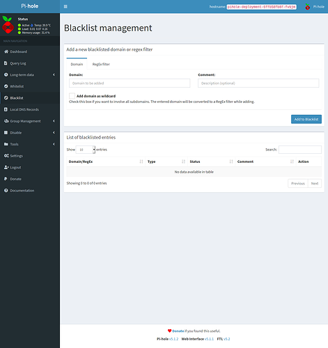

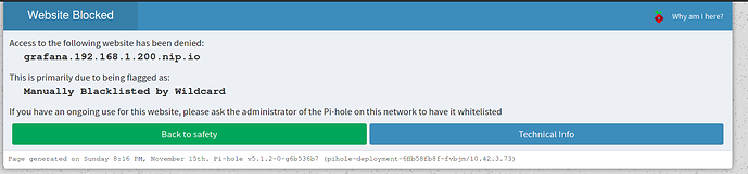

I used "grafana.192.168.1.200.nip.io", but Pi-hole blocks the domain due to not being on any blacklist, which i don't understand. Same goes for "xip.io" domains.
When adding the wildcard domain to the whitelist, it is still getting blocked, with the reason being:"Manually Blacklisted by Wildcard". I just whitelisted it, how can it be blacklisted? When blacklisting the wildcard domain it also displays the message above.
I don't know if i do something wrong or if it's a bug, it's my first time setting up Pi-hole and i couldn't find a solution online. I have added some screenshots.

I think the error is misleading. What it really shows (if you would use another blocking mode like NULL) is 404 - page noch found.

Does curl -I http://192.168.1.200/admin/ show an X-Pi-hole output? If so, then 192.168.1.200 is Pi-hole and not your grafana install.
Yes, this curl does give me an X-Pi-hole output. But because it is a cluster, i can access Pi-hole on multiple IP adresses, same goes for Grafana. Those adresses go from 192.168.1.200-203 (i got 4 Pi's)
That's a K8s/K3s issue then and not Pi-hole. Pi-hole is responding as it was designed. It has no idea that grafana is on the same IP address as Pi-hole, they should not be the same IP.
