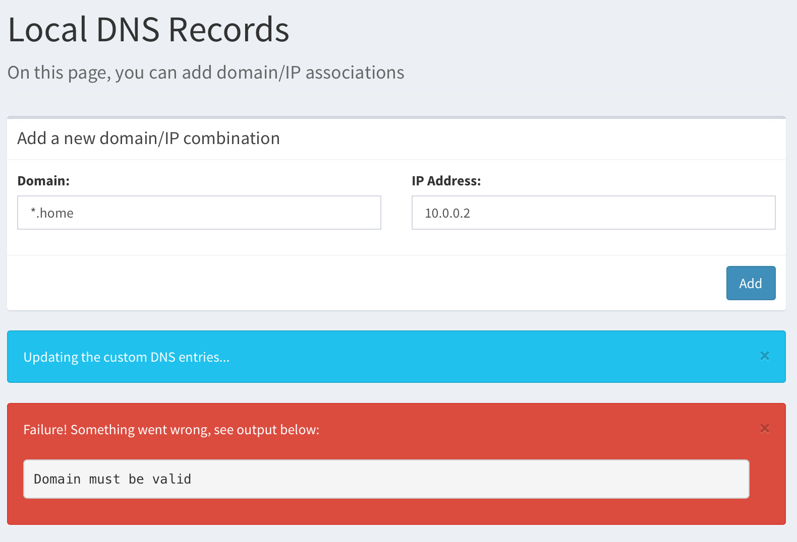

Am I doing this correctly?
You need to use an actual host name.
Mapping an entire TLD to an IP needs to be manually configured with dnsmasq config files. You can search for the common ways of doing that on the web.
