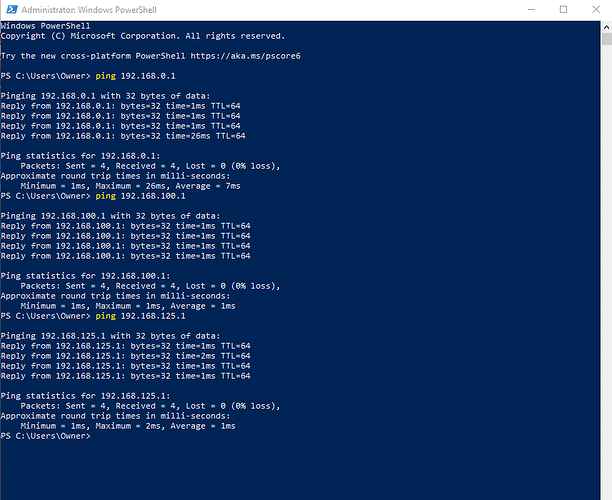

I pinged all of the gateways and all networks responded as they should, perfectly. I rebooted the router, Modem, switch, and pihole all at the same time (similar to a power outage) with same result. Is there a setting or something I need to do to get the wireless using the pihole as the DNS as they always have (I suspect they are still bit something is amiss) . I AM NOT an expert in this at all so I REALLY need help. My cell phones report "Internet may not be available" on both wireless networks. Alexas get the weather, but cannot use any of my Internet of Things in my House (thermostat, lights, etc). Alexa says they are not responding, which I expected.

Here is a screenshot pinging the gateways of all my networks.
