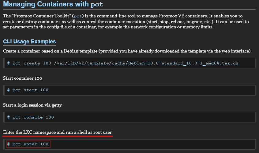

https://pmsl.com.ng/ssh-into-a-proxmox-lxc-container/
https://pve.proxmox.com/pve-docs/chapter-pct.html#_managing_containers_with_span_class_monospaced_pct_span
pct enter <vmid> [OPTIONS]
Launch a shell for the specified container.
<vmid>: <integer> (100 - 999999999)
The (unique) ID of the VM.
--keep-env <boolean> (default = 1)
Keep the current environment. This option will disabled by default with PVE 9. If you rely on a preserved environment, please use this option to be future-proof.
