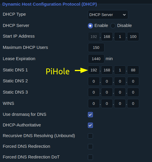

In my case, DHCP is done at the router see screenshot. The PiHole host got it static IP 192.168.1.88 from the router via DHCP reservation based on its MAC address. I could as well configure Debian to assign static IP. But it is simpler by DHCP reservation from the router.
For now I don't have redundant PiHole instances. So in case the PiHole is in trouble, I just need to change the Static DNS 1 value to a public DNS server. Then reboot the router.
