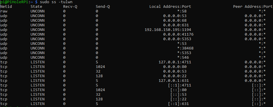

I believe I have all the necessary ports required by Pihole running on a RPi 3B+
While the SS command will show you ports being used it won't tell you whether or not the firewall is blocking traffic. If you are running something like UFW you will still need to open those ports.

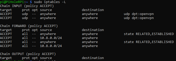

my Pihole has been working before and it's an install with default options.
in any case, it appears that firewall is allowing all traffics.
