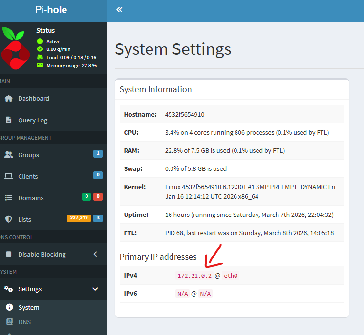

Pihole is running and working but when I use the container IP for my DNS it breaks my connection to the internet. Am I supposed to use this IP or something else?
No. This is the container IP and this IP is only accessible from other containers and from the host machine.
You need to use the host machine IP.
Just a note:
The IP on the image above is completely different from the IP on the compose file posted before.
Please, post the current compose file. We need to know your configuration to correctly help you.

I enetered the IP of the host machine locally on my pc and it seems to be working but if I try to enter it into my router I get the error “The IP conflicts with the LAN IP subnet. To use this DNS server, set it at DHCP server”
This is your answer.
You are trying to use Pi-hole IP on the wrong place.
You are probably changing the DNS server on the WAN (Internet) section, but you should do it on the "DHCP server" section of your router.
That did it! Told you I was a noob! Thanks again. I really appreciate the help.
