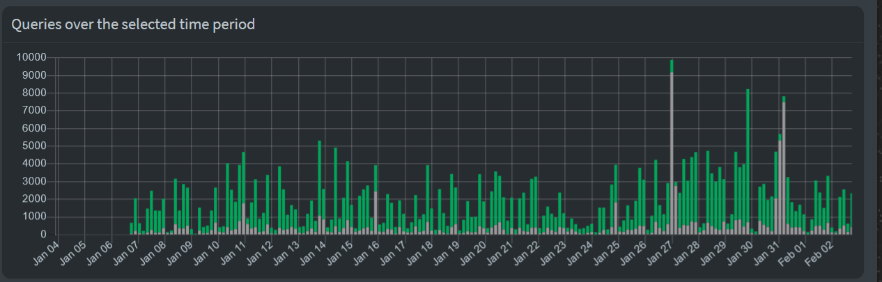

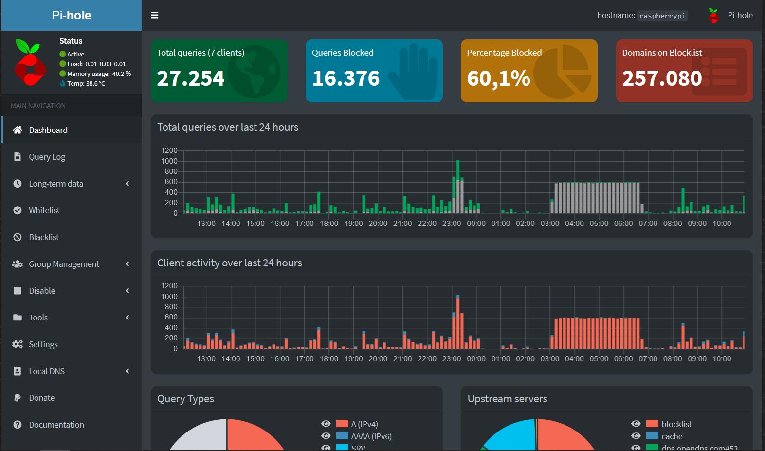

Why do I get 60.2% blocked during the night?
[Percentage of blocked sites costant during the whole day with little fluctuations (aroung 20-30%). Pi-hole version: 5.8.1]
[High percentage of blocked sites during the night with peak of 60-80% after the setup of "Allow only local requests".]

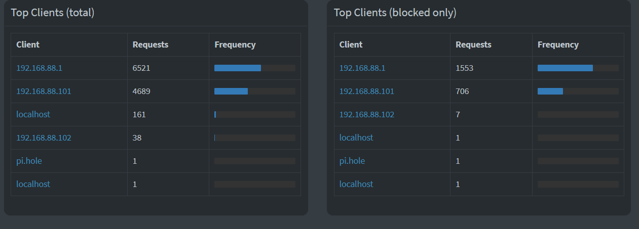

What handles DHCP on your network? It looks like all your devices are using one device for queries; so I'm guessing you have everything getting DNS look up forwarded from your router to Pi-hole? Conditional forwarding just lets your pi-hole get hostnames of devices e.g. iPhone, or HPlaptop.

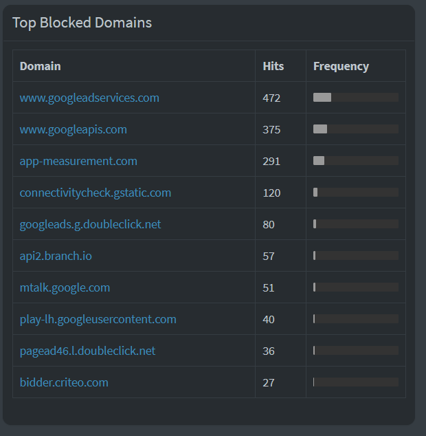

If you scroll down on the dashboard you will see "Top Blocked Domains"; that should tell you what is being blocked and some insight into what device is making the requests.
Also: Dashboard is a summary of the past 24 hours, not overnight.
I can see a ton of blocked requests between 0300 and 0700 and a spike at ~2300. From what I see you are getting 100% blocked queries at night. Something is trying hard to phone home.
So, it is 60% overall. If you put your cursor over the activity, it will tell you the exact breakdown.
Enable conditional forwarding tonight, and see what is making all those requests. It is not hurting anything to block it.
Screenshot the "Top Blocked Domains" for more help.

The blocked domains are "ad.doubleclick.net" and "www.googleadservices.com" over and over again from 0300 to 0700. It is strange 'cause I do not have any speaker at all, and the smartTV is off at that time.
Oddly enough, tonight I had some blocked domains (from 0300 to 0700) but not as high as the post, so I don't know what could. Maybe I configured the PiHole-Router interface wrongly and the firewall is open?

ad.doubleclick is an ad serving service, so that makes sense, They have been around forever. I remember seeing them in the late 90's show up on my Sonic Wall logs so often I manually blocked them.
Googleleadservices, however, is a hack. You need to find the device that it is running on and remove it.
If it only shows the router making the requests, then you are going to need to turn one thing off a night until you narrow it down.
www.googleadservices.com seems to be a proper google URL
https://pgl.yoyo.org/adservers/serverlist.php?hostformat=hosts&startdate[day]=7&startdate[month]=2&startdate[year]=2002&useip=0.0.0.0&mimetype=plaintext
There seems to be a lot of debate about it. Most people call it spyware and I did not read all the hits but from what I gather it can and is easily hijacked.
https://www.2-spyware.com/remove-google-lead-services.html
https://answers.microsoft.com/en-us/ie/forum/all/what-is-google-lead-services/00bad6d3-3318-4235-9682-0333e88f3fe4
Yes googleleadservices definitely seems like a malware / phishing but googleadservices is an official google domain meant for Ads (still tracking)
OP here seems to have the Google's official domain so probably they aren't compromised by an unknown source.

Observing the query logs as @Bucking_Horn suggested, there are peaks only on 26-01-2022 and 31-01-2022 (always from 0200 to 0700), and the IP of the device showing the request is the one of my router!
@demonshreder thanks for the info, but I don't know how to stop the requests coming from some device.
Yes it shows up as the router because your devices are getting its DNS lookup address from it, the router then passes the request to the pi-hole. There is nothing wrong with that. It is normal.
You did configure your router to send DNS lookups to the pi-hole, yes? You can configure each device and the router manually. It is just redundant, but you can see what device made the query if DNS is manually entered. You can close those ports in your router.

It looks like you do have a couple devices that are trying to manually get DNS and I'm going to guess that guide about forwarding 53 is working or you manually configured them.

Ok, it seems I understand the problem: the router (mikrotik) was sending tons of requests to "cloud.mikrotik.com" because of services like "internet interface detection", "cloud", "auto time sync" and "timezone". Just disabling all it stopped with all the requests.
