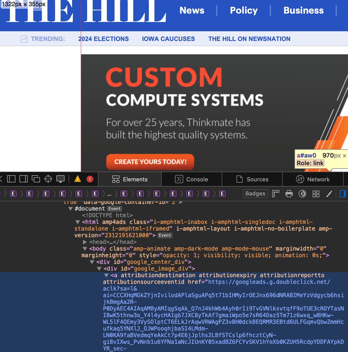

Thanks for that. I tried all your suggestions on both of the servers I mentioned, and both are indeed returned as gravity blocked. Here's a screenshot of the Safari inspector showing an ad from thehilll.com which shows it came from googleads.g.doubleclick.net, yet another adserver I can't seem to block, despite it also being in both the adlists referenced above
And here's the output of the tail on the pihole log for the same domain, on the same client:
Screenshot 2024-01-14 at 9.32.08 PM
I'm quite confused - how can it be blocked, yet getting delivered?!!
The <a ... href= ...> means that's where the banner links to if you click it, not where the image of the banner itself is being served from. Try right-clicking it and seeing if you have "Open image in new tab" or something like that. Or try the dev method again but you're looking for the source of the image.
