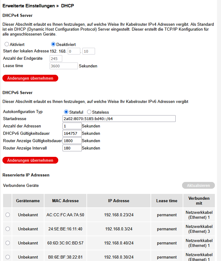

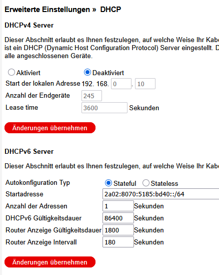

I have this setting on my Connectbox:
This worked with the pi-hole versions <V6 for a couple of years without major issues. Now, with the new version it looks like this setting is not compatible anylonger - but that's just my guess.
I get pi-hole running more or less, but after approx. 1-2 hours the internet is down. All I can do is to reset the router and start from new again. Currently I'm without pi-hole which is a pain in the xxx

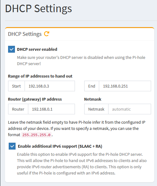

Your debug log shows your Pi-hole host machine to live on 192.168.0.2.
You have configured your Pi-hole's DHCP server to distribute 192.168.0.2 as router (gateway):
* Received 303 bytes from 192.168.0.2 @ eth0
Offered IP address: 192.168.0.227
DHCP options:
Message type: DHCPOFFER (2)
dns-server: 192.168.0.2
domain-name: "lan"
ntp-server: 192.168.0.2
router: 192.168.0.2
Commonly, you'd keep your existing router.
Is your OS actually configured to act as a router for your network?
If so, what's the reason why you want your Pi-hole machine to act as a router?

I'm not sure how I can set up IPv6 DNS on the router. I just have those option as you see in the screenshot above.
What really works strange: I hardly hat any issues with this setup using the pihole version <V6 - problems seem to start with the V6. I had no update in anyway in the router on the meantime.
