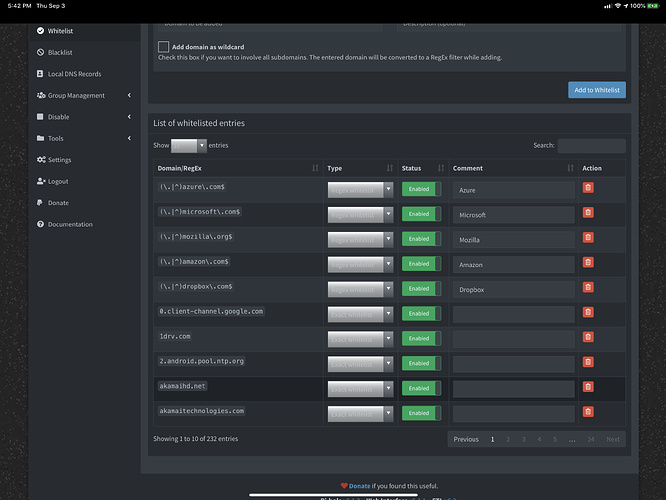

UPDATE: Deleting allowList entries to get the page size back to 23 fixed the issue. As soon as there are enough entries to make a 24th page, that column disappears. I can reliably reproduce the issue on my instance, so this appears to be a bug related to the number of allowList entries you can have.
So now I have a new problem: The group selector has disappeared altogether from the allowList form. I'm still fairly new to PiHole, did I flip a switch somewhere or something? This happened after I whitelisted a domain (which coincidentally made the page count go from 23 to 24, not sure if that's relevant or not). Strange eh? How do I fix this?
It is intentionally not displayed in "blacklist" or "whitelist" but in "Group management /domains"
