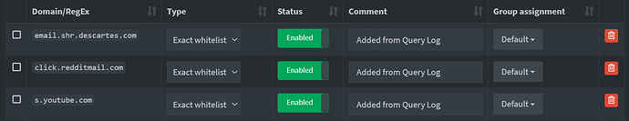

When I whitelist a domain, it will allow me to get that value in DNS.
I installed Pi-Hole through TrueNAS (not TrueCharts). It runs as a Docker container on their Kubernetes app infrastructure.
It's not machine-dependent either. My PC with two NICs and my phone on Wi-Fi both experience the same issue.
Pi-Hole allows me to whitelist domains, but for some reason, they still show up as blocked even in the Query Log where I whitelisted the domain.
Even if I disable the blocklists in Pi-Hole, I still can't get to those domains.

I noticed that some whitelisted entries work fine, but others do not. Is it possible there's a blocklist taking priority over my whitelist overrides?

Here's a simple one for when I try to click on emails from Reddit:
This might be a different issue. Now that I'm seeing this log, it looks like 1.1.1.2 said it doesn't exist, but I never had these issues from my UniFi router when it connected out to 1.1.1.2, but even if I query it or 1.1.1.1 directly, it still doesn't work.
