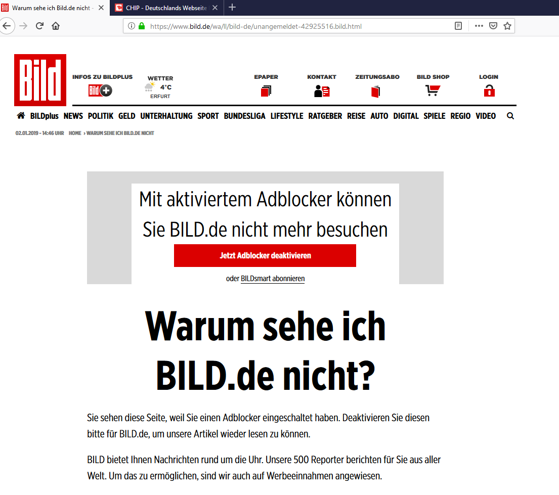

bild.de and chip.de are whitelisted, but they are still blocked. they worked yesterday, today they don't. tomorrow... who knows.
when I disable pi hole they work again.

"bild.de" and "www.bild.de" are two different domains. When you load the website you posted as "http://bild.de/", this actually loads "https://www.bild.de".
To whitelist this site, you will need to have "www.bild.de" in your whitelist.

just whitelisted them. do I need to restart the system for this to take effect?
No, but your browser will likely have the old information in cache. You may need to wait a few minutes for the cache to expire or clear the cache in the browser.
just cleared the firefox cache and even restarted. to no positive ending. it still blocks the page.
Since I'm not a native German speaker (or German speaker of any kind, actually), is that page telling you that you are running an adblocker and to turn it off?

In your screenshot, www.bild.de works as expected. However, you are seeing a page from BILD that tells you to disable your adblocker which is probably just not what you expected to see.
Go to your Query Log and whitelist the blocked (red) domains that are used by BILD for adblocker detection. They tend to vary so I cannot provide a recommendation for you.
ok, thanks for all your help to everybody. since they might change their adblock detection and I would constantly be unblocking sites and whitelisting, I have decided to just disable pihole for the 30 seconds I visit that page once a day.
