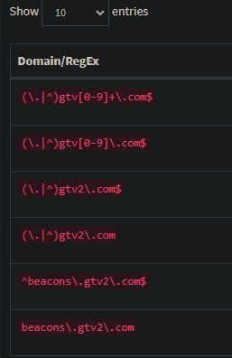

I verified white list regex matches yet still 0.0.0.0. If I add it as an exact whitelist it works and resolves. it's the regex whitelist I'm not having luck with overriding adlist.
feels like a possible regex whitelist bug to be honest:
tried all of these from advanced to real basic regex whitelist.

here are some more tests:
root@pi:~# pihole-FTL regex-test beacons.gtv2.com
[i] Loading regex filters from database...
    Compiled 17 black- and 15 whitelist regex filters in 9.935 msec
[i] Checking domain against blacklist...
    Time: 0.067 msec
[i] Checking domain against whitelist...
    (\.|^)gtv[0-9]+\.com$ matches (regex whitelist, DB ID 305)
    (\.|^)gtv[0-9]\.com$ matches (regex whitelist, DB ID 310)
    (\.|^)gtv2\.com$ matches (regex whitelist, DB ID 313)
    (\.|^)gtv2\.com matches (regex whitelist, DB ID 315)
    ^beacons\.gtv2\.com$ matches (regex whitelist, DB ID 317)
    beacons\.gtv2\.com matches (regex whitelist, DB ID 318)
    Time: 0.586 msec
root@pi:~# pihole-FTL regex-test beacons.gtv2.com  "(\.|^)gtv2\.com"
[i] Compiling regex filter...
    Compiled regex filter in 0.064 msec
Checking domain...
   Time: 0.036 msec

Those aren't the same domains. Try a regex for gvt2.com instead of gtv2.com.
OH WOW! slight dyslexia
Works
(.|^)gtv[0-9].com$
sorry for wasting your time and thank you for another pair of eyes. I was going crazy b/c I know regex WL was working.
