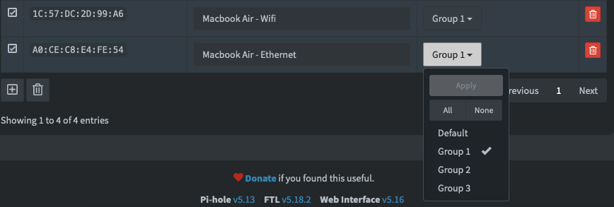

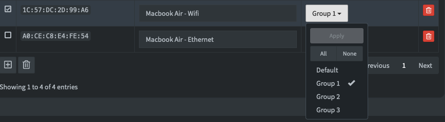

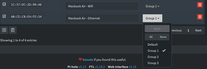

I created group 1, assigned several devices to group 1, and removed the association with the "default" group. However, ads are still being blocked. Anything I can do to validate?
In the screenshots, I added my MacBook ethernet and wifi device to group 1 for testing.

Double check that you have indeed removed the device from the Default group. You have to set the ticks correctly and then click Apply to make the changes. If you just click away, thinking the ticks were enough, the changes are not saved.
Hi Chris, Thanks for your response. I double checked a few times, and the device only has "group 1" assigned.

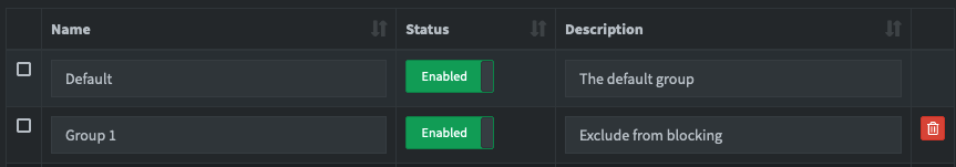

  • You created the Group 1 "Exclude from blocking" (id=1).
  • You have 4 Adlists associated to Default Group (id=0).
  • You also added 4 clients and associated them only to Group 1.

Does your configuration meet the preconditions I've mentioned?
Screenshot 2022-11-13 at 9.50.01 AM
That looks about alright.
