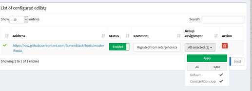

Once you have your groups created you decide what lists should be applied to each group:
*** [ DIAGNOSING ]: Adlists
   id    enabled  group_ids     address                                                                                               date_added           date_modified        comment
   1           1  0             https://raw.githubusercontent.com/StevenBlack/hosts/master/hosts                                      2021-03-07 10:22:50  2021-04-15 15:02:07  Unified hosts
   5           1  5             https://raw.githubusercontent.com/StevenBlack/hosts/master/alternates/fakenews/hosts                  2021-04-15 15:02:38  2021-04-15 15:19:02  Unified hosts + fake news
   6           1  4             https://raw.githubusercontent.com/StevenBlack/hosts/master/alternates/porn/hosts                      2021-04-15 15:03:15  2021-04-15 15:09:18  Unified hosts + porn
   7           1  10            https://raw.githubusercontent.com/StevenBlack/hosts/master/alternates/fakenews-porn/hosts             2021-04-15 15:03:47  2021-04-15 15:19:09  Unified hosts + fake news + porn
The flexibility of groups means that you can apply lists to multiple groups if you'd like.
Once you have the lists affecting the groups then you assign clients to each group. In your case the tablets go in to group 10 and they have group 10's lists applied.
You can think of a group as being a Virtual Pi-hole or a vLAN. However you can expand on that and have a client in multiple groups if you wanted. If the lists you used were not aggregated and they were unique lists then you'd want the tablets to be members of each group and have all the lists applied. Or you could have the tablets be a single group and then make each list apply to that group. There's a ton of flexibility built in and you can design the scheme in a way that makes sense to you.
I think it's manual. Adding a domain or regex via http://pi.hole/admin/groups-domains.php puts that entry in the default group. You then have to click on Group assignment to map that entry to all the groups that you would like it to be applied.
