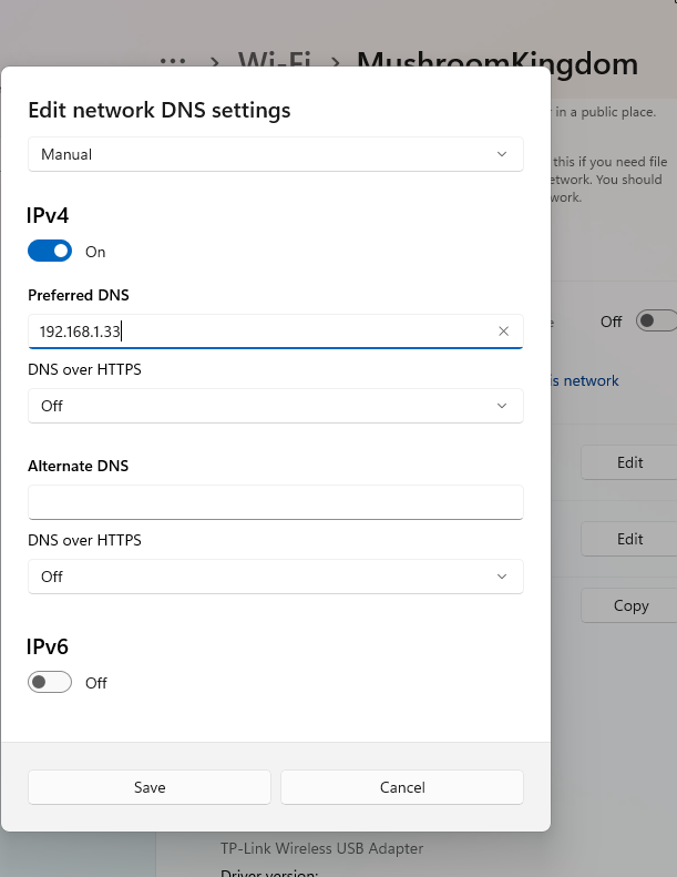

Thanks. What I mean is on this screen in win11, if I leave ipv6 off then windows sets my DNS to both a ip4 and ip6 address (of my router) and I get adverts as it chooses ip6. So the only way I could get it to work was to enter an ip6 address. Hence asking which to use.
I cannot disable ip6 because it is needed. So is the answer to use the local address that pihole is stating is it's ip address, i.e. fe80::655f:1762:541b:e888?
My advice is applicable regardless of where you configure IPv6 DNS server addresses.
IPv6 is disabled in your screenshot above?

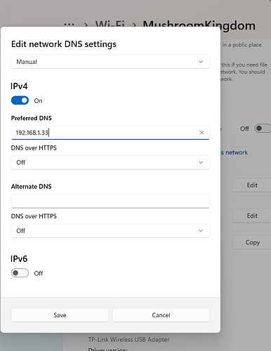

What I'm saying is if I set this ipv6 toggle to off here in this section of win11 setup for my computer, then the computer defaults to the router ip6, i.e. turning it off does nothing and neither does flushing my dns, resetting ip, etc.
