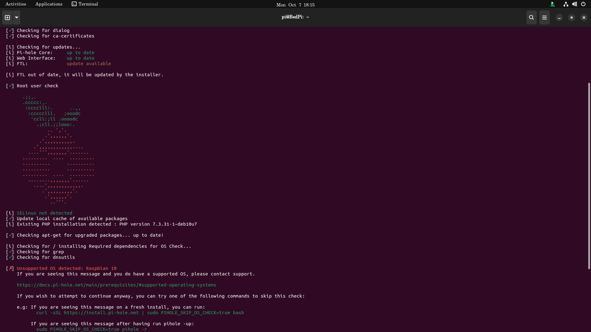

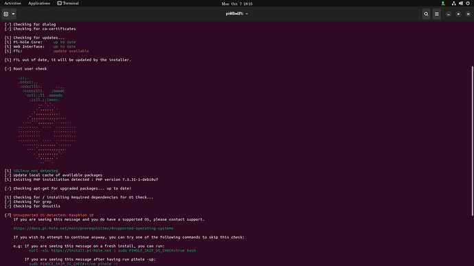

The issue I am facing:
When I try to update (pihole -up) I get a message saying "Unsupported OS"
Raspbian 10

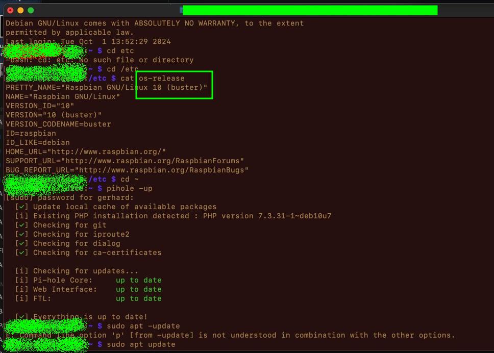

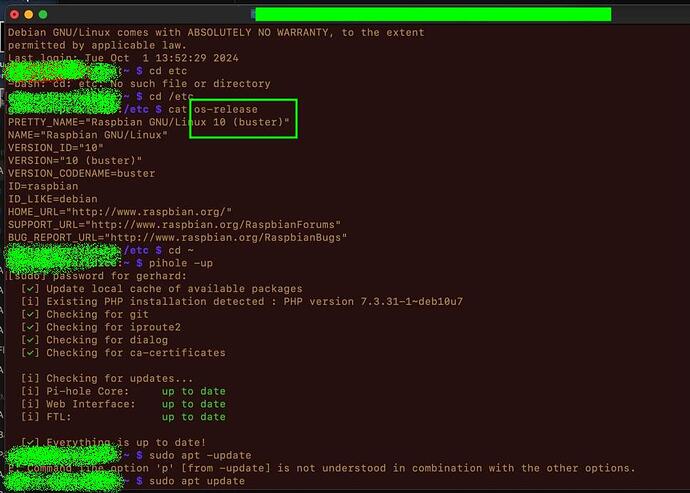

This is what I see/get:
But they are running BUSTER and they CAN use the pihole -up command.
Though their install is up to date already.

So why is it that the other person could run the command pihole -up today and it accepted it, yet, when I do it: I am told the OS is out of date/EOL?
Both same version of the OS on his and mine.
And I am still getting updates for Buster?
Maybe the EOL check was added in a later version and the person in question had a Pi-hole installation that did not check for it. Also, you're up to date according to your screenshots. This is just a warning but does not hold you back from updating.

But the only visible difference between the other person's machine and mine is the FTL version.
It may be nice if I could update FTL.

If you do a dig -t txt versions.pi-hole.net it will list the officially supported OSs. This is basically how the install script and update script work.
versions.pi-hole.net. 5 IN TXT "Raspbian=11,12 Ubuntu=20,22,23,24 Debian=11,12 Fedora=39,40 CentOS=9"
You can try to update using PIHOLE_SKIP_OS_CHECK=true sudo -E pihole -up
There is a risk in doing so though. The differences between os versions can grow especially as security updates are added to newer versions but not those that are EOL.

However the "solution" to your issue is in your own screenshot :slight_smile:
That said, as @stonerl pointed out - Debian 10 is EOL, and as such is not officially supported by the maintainers of Debian / Raspberry Pi OS, so it may be a good idea to look at upgrading to a newer version of the operating system so that you are up to date with the latest security patches and improvements there.

The screenshot came DIRECTLY from that person to me.
They are my go to person for initial help on a lot of things.
(Shame on me for putting that much responsibility on them.)
I asked if theirs was Up to date and they said yes.
I then mentioned it is weird that I can't update mine.
We checked with each other and they have the same OS installed on theirs as I do on mine.
The only difference was the FTL version.
They updated theirs recently. Within the last week or so I seem to remember.
I did mine that day and was told it is not supported.
They tried to update theirs (as per screen shot) and it worked.
Though it was up to date and so nothing needed updating.

We store the list of updated OS's as a TXT DNS record, and this is what the installer/updater checks on an install or repair.
dig +short -t txt versions.pi-hole.net @ns1.pi-hole.net
This is always up to date, but we appear to have missed an update in our documentation.
You can :slight_smile:
As has been pointed out by myself (and someone else)...
sudo PIHOLE_SKIP_OS_CHECK=true pihole -r
and if that does not update (it should) run:
Looking again at your friends screenshot - they're already up to date, so the updater script would not have hit that part of the code. It is likely that they already got the OS warning when they first went to update, and then they followed the instructions in the message... :wink:
