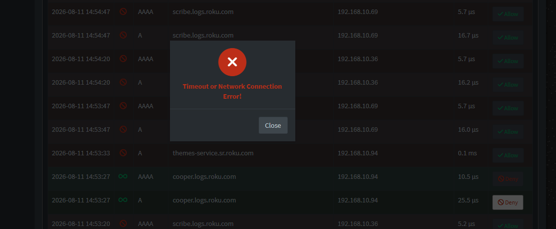

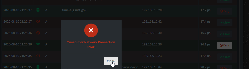

When I try to 'deny' a host / domain I get Timeout or Network Connection Error!
I go to the "list all queries", find the one that I want to block and click the 'deny' button and expect it to acknowledge and block that domain / host going forward.
When I click the deny button it pops up with an error "Timeout or Network Connection Error!"
This worked for a while and everything else still does. Been running for maybe a couple months and had blocked everything I wanted to (in addition to the built ion list). I found a new host and tried blocking it, but get the error mentioned above. I tried restarting but no change. Not sure what to do, check or try, so any suggestions are much appreciated!

Just to be 100% clear, on the first post I was trying to say that I was trying to block a domain that had apparently just been accessed successfully as best I could tell from the 'recent queries'.
Basically at 14:55 I saw the 'recent query' from a minute or so earlier at 14:53:27 (seen in the previous picture). That was green and because of that appeared to me to have been a successful connection or DNS resolution. Since it showed in green, and was successful a minute before, I assumed that it wasn't in the list, so I hit the block button and got the error.
So I totally get that it's trying to tell me that it it's already on the list with that message, but don't know why it isn't being blocked / showing as blocked in the recent queries from just a minute and a half before if it is already on the list?

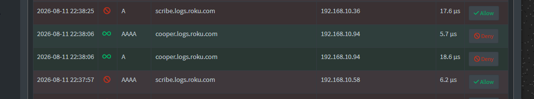

An updated example, I tried to block cooper.logs.roku.com this afternoon and got the error, indicating it's already blocked. I saw it still comes up green as of 22:40 tonight, and when I clicked the deny button at 22:41 I got the error. Again, if it is on the block list already that makes sense, but if it is, why is it coming up green in it's most recent queries?
Thanks again!

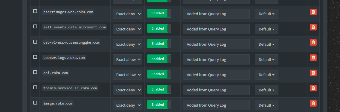

Sorry, I finally found the domains list. Checking in there, I see that the domains in question somehow got explicitly ALLOWED, in addition to being denied. I removed that, and will monitor to see if it gets blocked going forward, and confirm.

Looking at the log again, I see both entries: one to Allow and one to Block.
When this happens, the Allow rule always wins.
Now that you removed the allow entry, the domain will be blocked.
