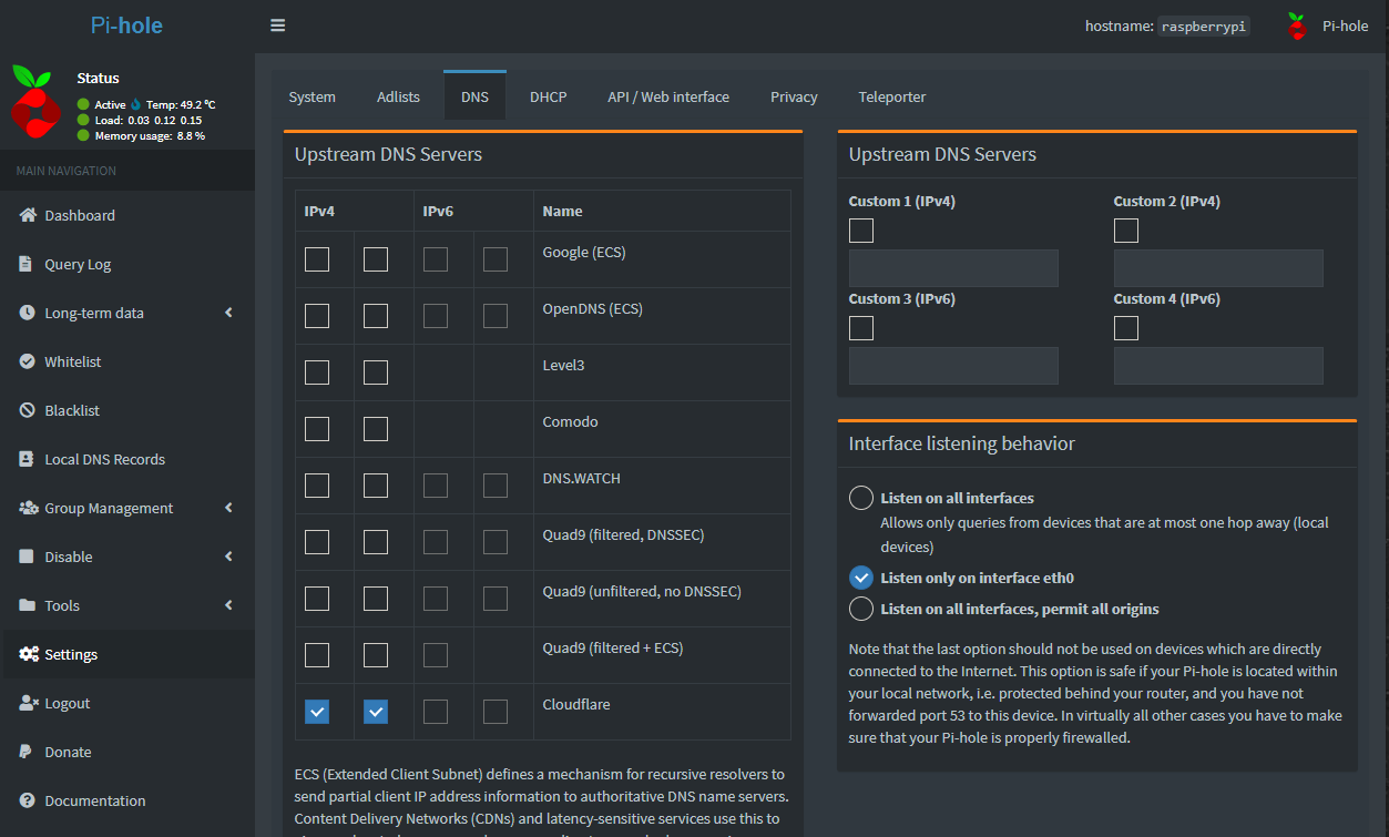

i have been using Cloudflare DNS, is there a better or more preferred one to use. if i change the DNS from the web login do i just click save and we are good?

You will have to decide which public server best meets your needs.
Or, run your own and avoid third party providers completely:
Yes.
what are the differences between the 3 Quad9's how do i know what one to select? Also as there are 4 boxes do i have to put check in all 4 of the boxes per dns on the web interface or jus the on under 1Pv4?
We provide a description next to each. Decide if you want DNSSEC, ECS, etc.
If you aren't using IPv6 then select the IPv4 servers only.
sorry i guess that was a dumb question, but i just don't understand the difference even after reading those. i noticed that switching to the quad9 ads are appearing in my ios apps where they didn't on Cloudflare. i am just tying to find the best one as i have only used cloudflare.
Thank you
Try them all and see which works best for you.

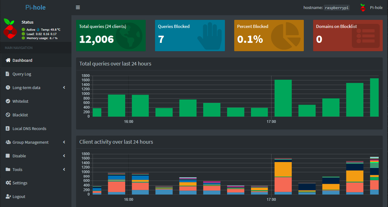

You have zero domains on blocklist. Rebuild gravity with pihole -g
or using the web admin GUI tools menu.
hmmm how did that get messed up showing this:

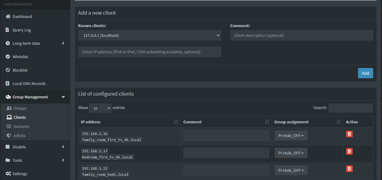

You have 3 clients assigned to group 3, and no blocking assigned to that group.
But, you also have the default group disabled, and all the blocking is assigned to that group. As a result, nothing is blocked for any client. Enable the default group and rebuild gravity.
ok, i guess i have no idea what i am doing. i am trying to have the pi-hole on for everything on the network except the devices below.
Thank you
That looks like what you want.
great, thanks for your help @jfb appreciate your time.
