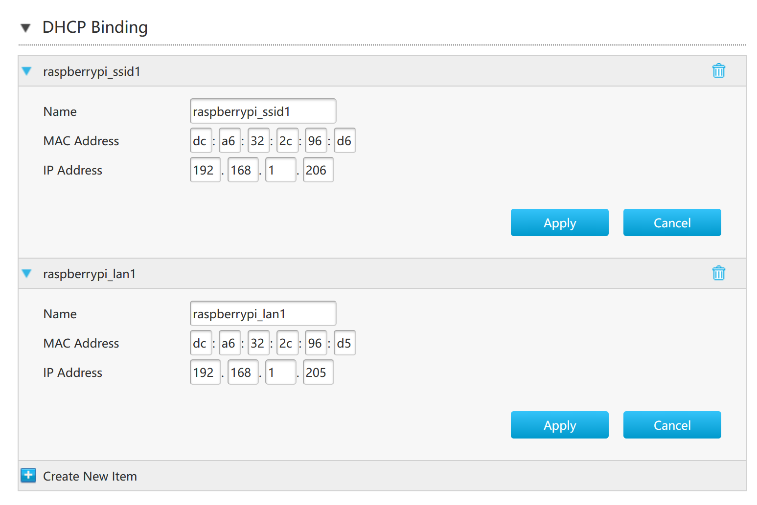

  • I configured my router to bind the Pi’s IP address. Here’s how it looks like on my router’s web interface:

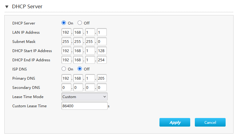

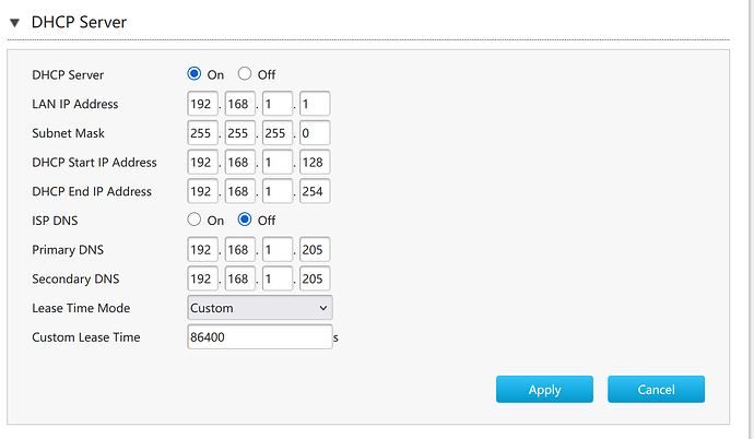

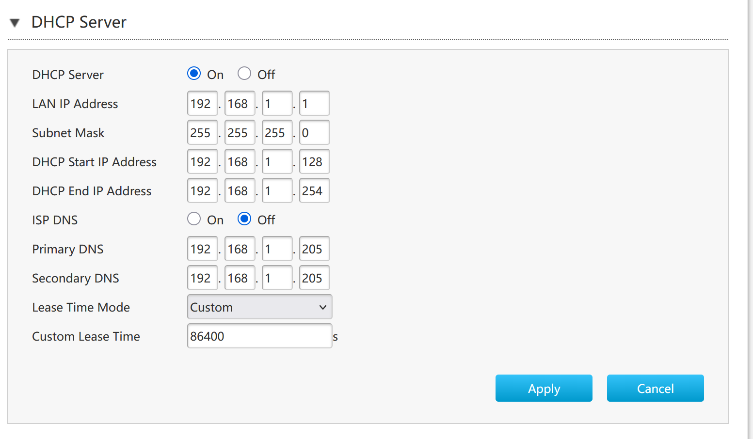

  • I configured the router to use the pi as the DNS. Here’s how that looks like:

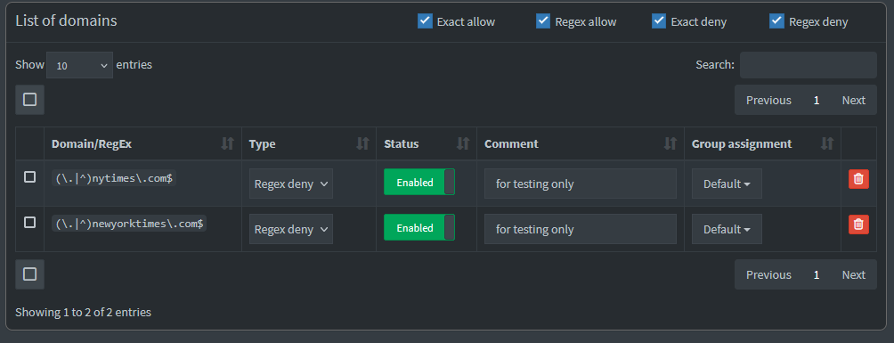

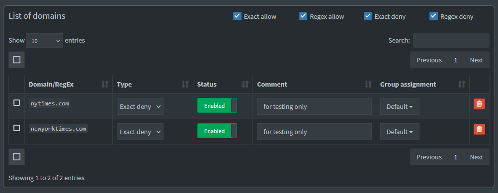

  • I added nytimes.com and newyorktimes.com to the denied domains list using the pihole web interface:
  • I opened newyorktimes.com on my laptop, and it loads without issue.
  • I tried restarting my laptop, disconnecting and reconnecting to the wifi. Did not resolve issue

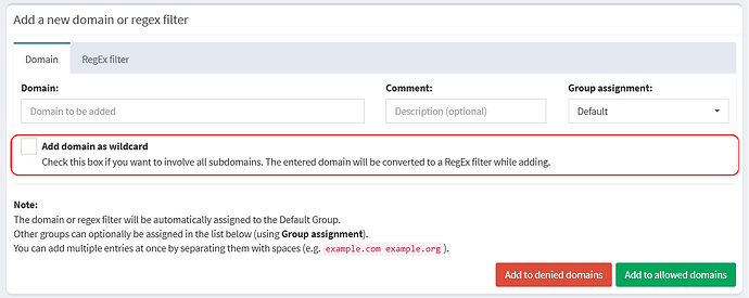

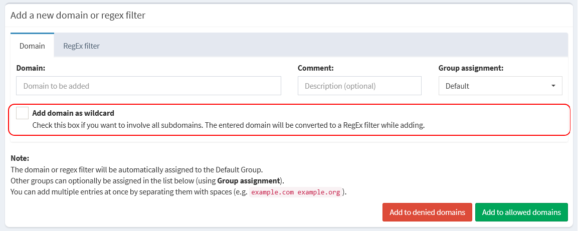

You blocked nytimes.com, but you are accessing a different domain: www.nytimes.com.
From DNS point of view, there is no "subdomains". This is just a different domain.
If you want to block every thing ending with nytimes.com, you need to mark the "wildcard" checkbox before you click on the "Add to denied domains" button:
@ rdwebdesign Thanks for responding.
I tried adding the domains again with the wildcard checkbox on, but I am still able to browse https://www.nytimes.com/ in my laptop’s browser.
Those are regex deny rules, you need them to be regex allow rules.
@ nosugref42 but my objective is to block NYT, not to allow it!
regardless, I just now tried to change the Type to Regex allow and, alas, I am still able to access NYT on my laptop.

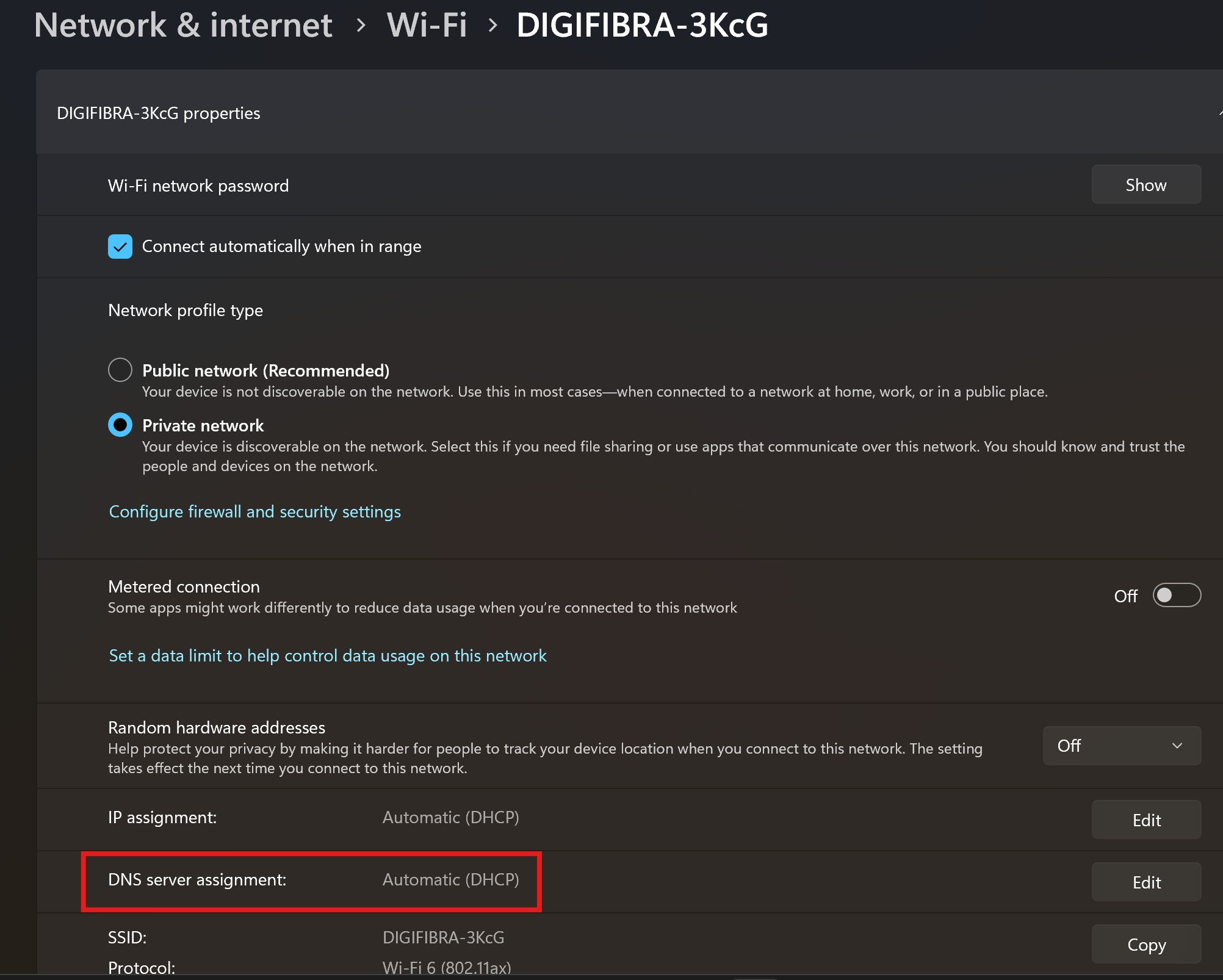

  • @ nosugref42 Here is a screenshot on my laptop of the wifi settings of the network emitted by my router. About DNS it says “Automatic (DHCP)”.

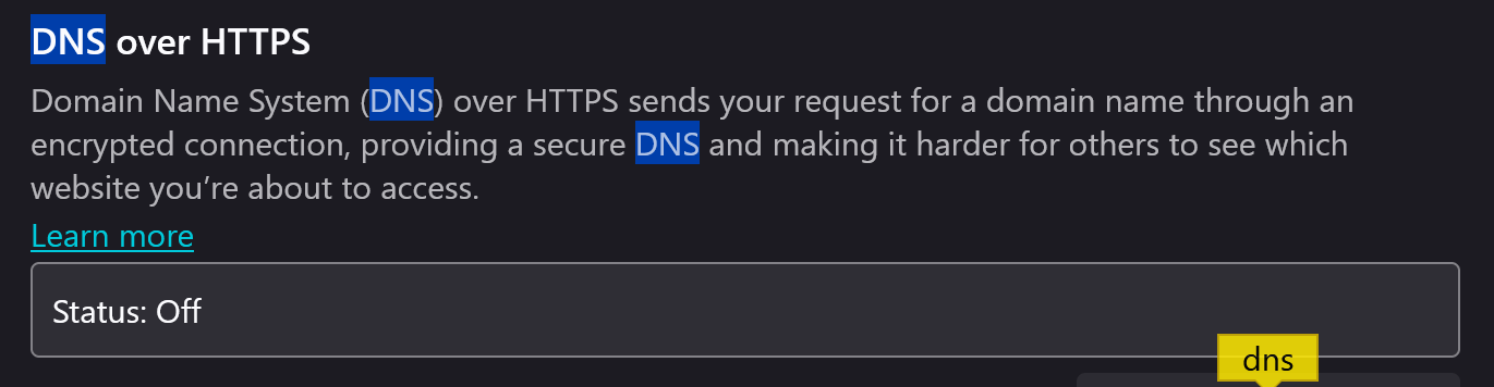

  • Also, I checked Firefox for the setting you mentioned, and it appears to be off:
  • @ stopwastingmuhTime see above point
From your screenshots it looks like you are probably using a ZTE router/modem (possibly re-branded by your ISP).
These will often advertise their own address via DHCP as another DNS server (and in all cases do perform as a DNS server, forwarding your query upstream to your ISP’s server if a device queries them).
In some cases these also do not cope well if you specify the same address for both “primary” and “secondary” DNS.

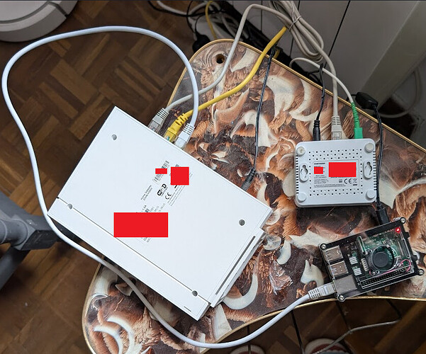

@ robgill the router in question is indeed a ZTE router. Here’s a picture of the label, with some details redacted for security.

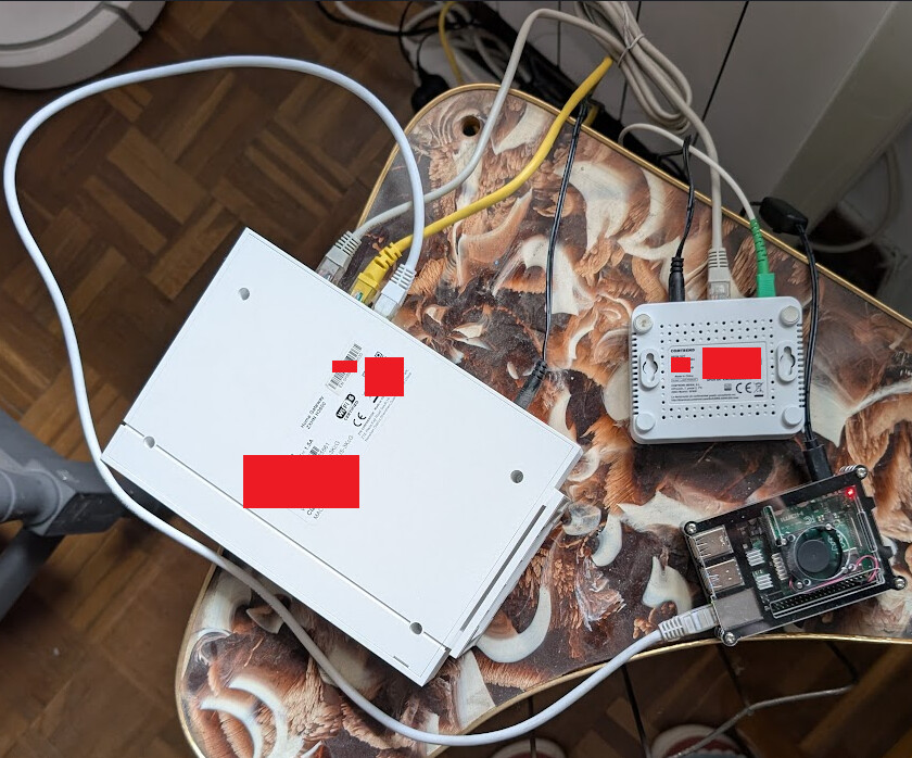

  • Also, here is what my home network setup looks like. There’s the ZTE router, which is connected via ethernet cables to both the Raspberry PI and a GRG-4284 fiber optic cable thingamajig, and a third connection (the yellow one) that goes to an uninvolved PC.
Thanks. From these we can see that your router is only listing your Pi-Hole as the DNS server for IPV4, which is good.
