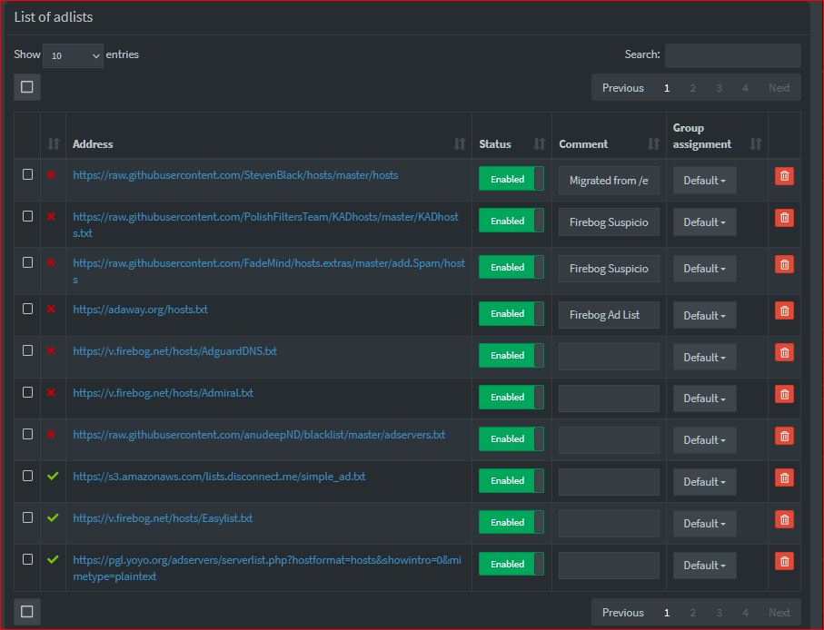

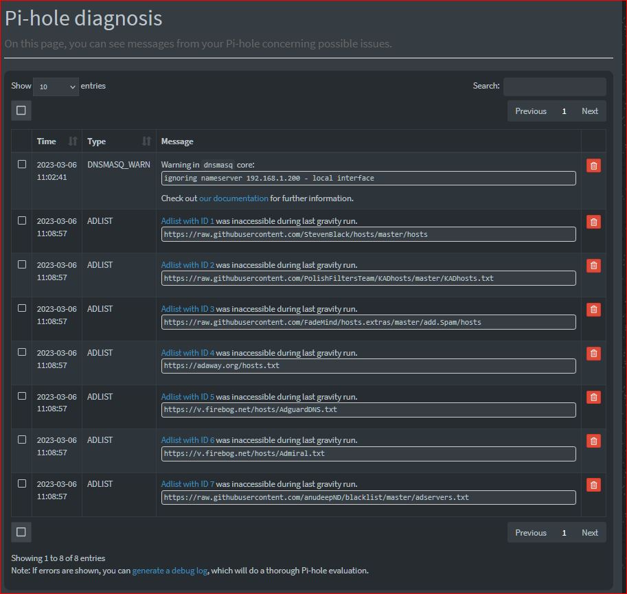

Some Adlists are giving Adlist with ID X was inaccessible during last gravity run. Not sure if this is affecting the percentage - however this has only been in the last 1-2hrs and I am under the impression the stats shown are for the last 24hrs.
edit: I have noticed now that when I go to speedtest.net the ads are not being blocked - these were being blocked before
**EDIT: based on the help received below - the problem was that I had created custom groups but not assigned any of these custom groups to my adlists. Once assigning all my devices back to default group the blocking was working.
The "adlist with ID X was inaccessible during last gravity run" problem was resolved by going to tools > gravity update as per chrislph advice.

  • Click on the adlist URL on that page. That will load it or download it in a new browser tab. Can you access any of them that way? That will at least show if they are indeed reachable or not.
  • Run Tools > Update Gravity again. Does it work this time around? Perhaps your internet connection was having a moment during the last run.

I tried them and they all direct to a text file that has the list of domains there. I'll try updating gravity again and see if there is any change...
edit: since updating gravity it has removed the red cross marks and the errors I was getting, so thank you for that! but I am still getting ads on speedtest.net

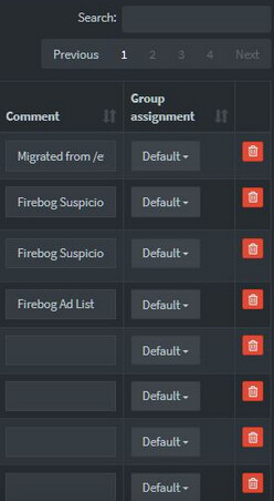

You need to assign adlists or domains to various groups. This is done in the adlist and domains tabs in the Pi-hole web admin GUI.
Your screenshot and your debug log shows only the Default group is using adlist.
You need to change the "Group Assignment" for each adlist.
The field is currently set as "Default".

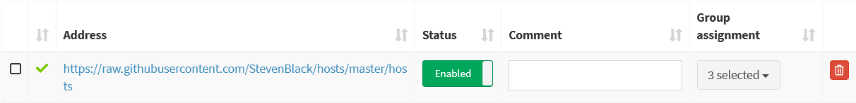

You need to change this (click on the button and select the groups you want to apply to each list).
The button will show something like "3 selected":
