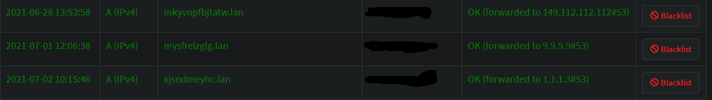

Hello, i've been looking at my query log and noticed a few weird entries, they are jumbled letters that end with .lan and are resolved by the external DNS while showing as secure

Could you share some samples?
If those would occur in packs of mostly three, then that could be a Chromium browser connecting to three random domains at startup.
yes, they do appear as packs of three, that's so strange though.
here's an example:
I picked this because it's a windows phone that does not have a chromium-browser. so are all devices checking connectivity this way?
MS has switched its browser engine for Edge to Chromium since mid 2020 (though I don't know whether that would apply to Windows phones as well).
Maybe, but I wouldn't know that for Windows phone.
Regardless of browsers, you could check if you can correlate those entries with a browser starting.
In any case, those are valid queries initiated by your client.

the weird thing is that it's been resolved correctly by the external DNS servers even though they're under the lan domain.
The Reply column is absent from your screen shot (likely because you are using the Long term query log), so all that can be inferred from it is that a query was forwarded, but not that it was resolved into an IP.
Given that they are for .lan, I'm very confident that all of those queries have been answered with NXDOMAIN, which should be verifiable by inspecting a more recent query in the Query Log.
they are indeed NXDOMAIN, what does that tell us? that your theory is correct and the devices are checking a random string and waiting for any response from the DNS?
if so, is there a way to group these? or hide them?
It tells us that neither your router nor your ISP would redirect DNS requests for invalid or unknown domains to a web page laden with ads for barely related terms, which is likely what the client software issuing those requests is trying to find out about as well.
From a DNS point of view, everything is working as expected.
