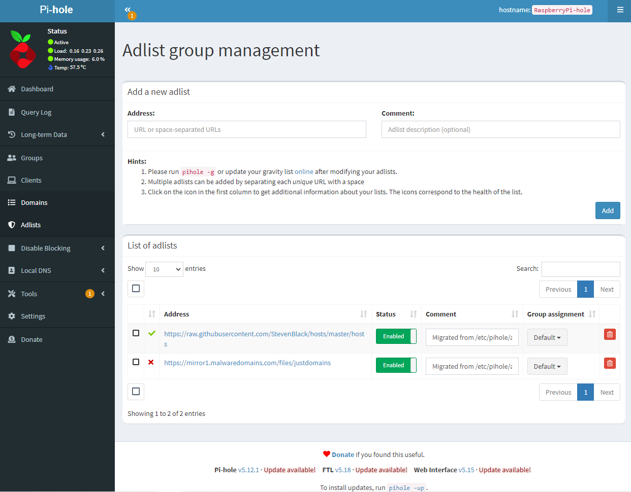

In my DrayTek router I did have both Primary & Secondary DNS Servers set to the same 192.168.0.xxx internal IP address of Pi-hole but over the weekend I removed the secondary to leave it blank and I notice now on some devices the Secondary instead of showing internal Pi-hole IP address is displaying an external IP address from my ISP. Not sure what do set for the best here?
Pi-hole is set to use Cloudflare (DNSSEC) and is set to never forward non-FQDN A and AAAA queries and is not acting as a DHCP Server.
It is showing 1 notification against Pi-hole diagnosis but when clicking into it there are no errors shown?
I don't know where else to look or what to do apart from generating & sending a debug log so I have already taken the liberty of doing this and my debug token is https://tricorder.pi-hole.net/td2Izrkj/
Strangely I done a pihole- up followed by sudo reboot only a day or so ago and yet I see all three elements; Pihole, FTL & web Interface are showing as can be updated?
