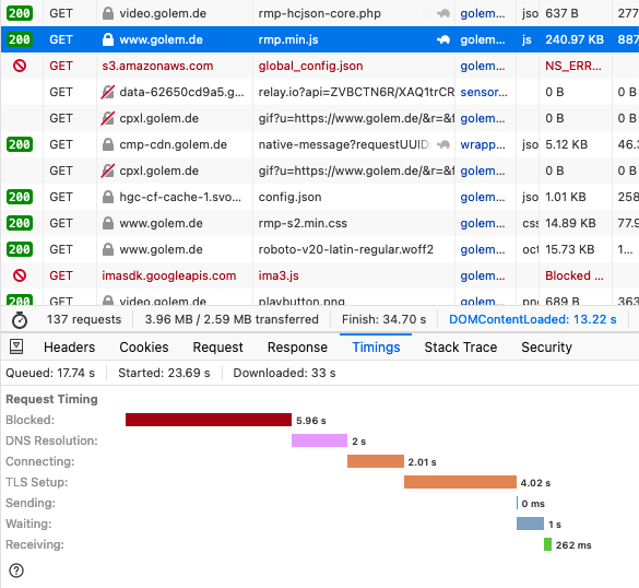

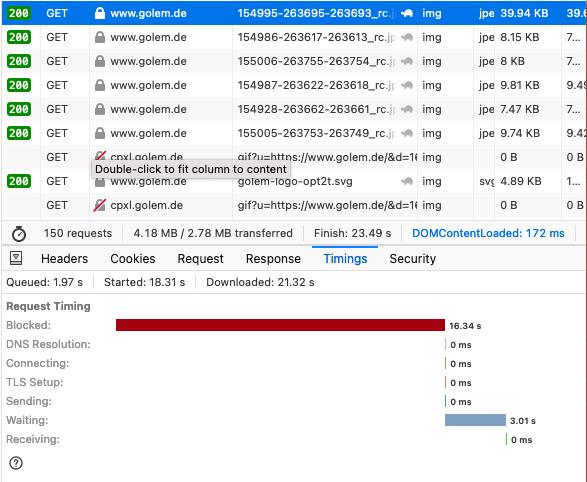

Here are two examples of timing analysis in Firefox:
That looks really strange.
From the pictures you posted I think this is a network issue and not a DNS issue (even though DNS resolution is listed as "2 sec"). I have no idea why "Blocked" is listed at all and why it does take so long.
