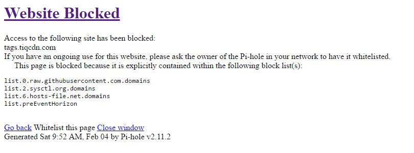

  3. http://tags.tiqcdn.com is instantly piholed

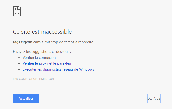

Do you get an error if you go directly to a blocked URL that times out?
Hi Mcat12,
Yes I get an error, saying the website is unreachable because it took too much time to respond.
But the message only occurs on HTTPS, on HTTP, the website is instantly piholed and the pihole page is displayed
When I look at pihole debug, nothing seems to happen when i browse https://tags.tiqcdn.com, however things happen when i go to http://tags.tiqcdn.com
The issue really seems to be limited to ad domains hosted over HTTPS :s

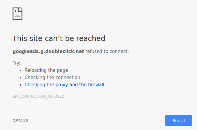

We still block HTTPS ads, just for some reason your install is timing out on HTTPS ads. The reason that HTTPS ads return that error instead of displaying the block page is that since we redirect the request for example.com from the original server to Pi-hole, the browser does not receive the correct security certificate and correctly assumes that there's some misdirection going on. This is a security feature, but either way the ad is still blocked. You probably could get around it with a self-signed wildcard certificate, but that opens up loads of security concerns and is not recommended.
I concur.
Most (if not close to all) users do not see issues with HTTPS requests as they don't see ads but immediately get a connection refused error:
I think I might have spotted the issue:
I run the pihole in a docker container, with specific ports forwarded. Before installing a self signed certificate, I only forwarded port 80 and port 53.
docker run -p 53:53/tcp -p 53:53/udp -p 80:80
When I installed the certificate, I also added port 443. Maybe its that part that fixed the issue! As the port was closed, the connection always timed out!
