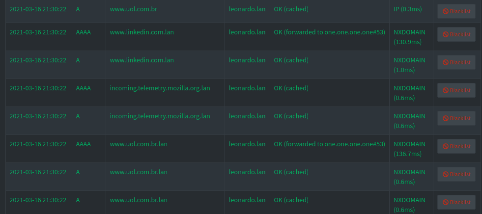

One thing I tried to analyze was that when slowness happen, I see the following calls from ipv6:
Why would it make these queries to .lan? it seems to do that every once in a while for every domain I access at that period
