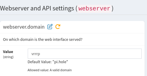

i changed that webserver.domain value to piholevrrp and now PiHole displays the notification in Tools > Pi-hole diagnosis :
Type : CERTIFICATE_DOMAIN_MISMATCH
Message : SSL/TLS certificate /etc/pihole/tls.pem does not match domain piholevrrp!
Safe to ignore or what action should i need to take?
Setting piholevrrp as the value for webserver.domain did not resolve my issue.

I left the value for webserver.domain as pi.hole, then later changed it to piholevrrp.mydomainname and the sessions timed out each time.
I cleared the cookies each time.
Every time you change the domain you need to delete the SSL Certificate and Pi-Hole will generate a new correct one :wink:
It was one of the first things I did when Pi-Hole v6 was released and HTTPS access is working just fine since that time!

After i created the new instances and changed the webserver.domain value to the same value that I use to access the web UI, I deleted the existing tls certs and regenerated by restarting the pihole-ftl service, but i still experience the timeout issue at random times.
I’m not worried about using the default self-signed cert and not accessing the UI via https.

As suggested by other members here, I also changed the entry for webserver.domain from the default “pi.hole” to “piholevrrp.mydomain.com”, which resolves to a dns entry i have in Pi-Hole so i can enter that rather than any of the direct IPs or vIP into a browser.
When i do this though, should I still be able to ping pi.hole from another network client (after flushing the client’s dns cache)?
When I do, it resolves to the direct IP of instance #1, assuming because is the vIP master at the time.

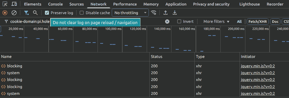

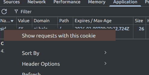

I'm really grasping at straws here - perhaps rdwebdesign can tell whether it would be possible that those calls were involved in premature timeouts?
Perhaps we can try to catch the HTTP request that clears the session (if it were a HTTP request to do so).
When viewing your session cookie in your Chrome browser's developer tools, does that allow you to trace related requests via context menu?
If so, could you keep that view open while waiting for a timeout to occur, with Preserve log enabled?

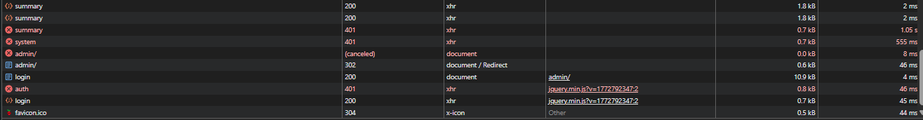

Thanks for the response and sorry I didn’t respond sooner.
I didn’t realise (or know) that you had responded 5 days ago until the more recent responses from yourself and @rdwebdesign in the last few hours when I received email notifications from both updates. I didn’t receive an email notification from your response 5 days ago.
Anyway, I did as you suggested and started a new web UI session and viewed it in dev tools until the session timed out, which didn’t take that long.
This was the end result of the session timeout :
From these events, is there anything specific that you would want to dig further into?
