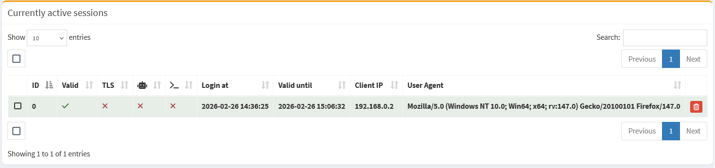

Your log shows webserver.session.timeout is set to 86400, as you said.
What do you see on Currently active sessions table, on the Settings > Web interface / API page?
(You need to change to "Expert" mode to see this table)
Check the "Valid until" column.
If the session expiration time is correct, but the session is expiring before that, maybe the issue is on the browser side:
  • Did you try to clear the cache and cookies?
  • Do you see the same if you try on a different browser or different machine?

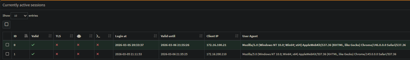

I have the following showing for Currently Active Sessions :
For reference, it is currently 7:15PM on 27th February.
All sessions have a Valid Until date & time that are at least 3 hours from now.
How many sessions should I normally be seeing - just a single for the primary display (Dashboard screen)?
IP address .200.210 is my "dashboard" computer and .100.21 is a secondary computer I am testing from.

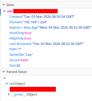

Can you please get details of the cookies generated from your scenarios above (all combinations of each instance as vIP MASTER accessed via direct IP, and vIP address), gather each after clearing cookies and cache.
If you have firefox installed, the view is available in More Tools -> Web developer tools -> Storage.
Please list all of the fields in my screenshot but be sure to redact the "SID" fields before posting, and also redact your domain if it is not a generic domain such as .home.arpa or .internal.
Is this what you are/were after???
vIP MASTER - vIP address (172.16.200.21)
vIP MASTER - direct address
Yes, exactly.
For that first one, can you confirm you accessed it via the IP and not by the domain "piholevrrp"?

Session information from two different computers on my network :
Both sessions are via the piholevrrp domain address.
