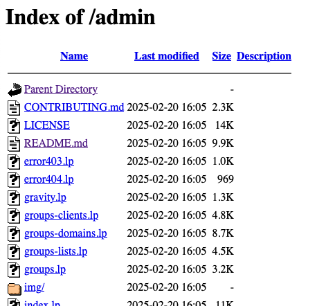

I upgraded to v6 today and have encountered an issue where the webview doesn't load/render anymore. It's not a 404 or a redirect, when I navigate to https://my.domain/admin/ I'm just provides the folder structure for the admin folder. Calling the API routes does 404. Using an explicit port does not provide access to the webview, either, as noted below.

No webview is presented, only the folder structure.
