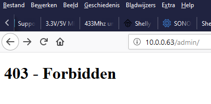

Webadmin : 403 forbidden
See the admin webpage_
403 forbidden_
https://tricorder.pi-hole.net/8sk60cmuwk
Are you trying with /admin/ ?
