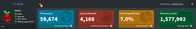

Long storry short : I was very happy with v5 but all of a sudden dns query were not resolved using cloudflare dns. So I updated :smile:
Now clouflares resolving still do not work, but also my web gui.

Also I notice the CPU is overloaded (200+ %), it wasn't the case before upgrade.

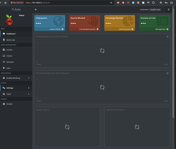

Webgui is still loading very slowly
This screen is taken after 5 minutes load
and DNS resolving is not working anymore :face_with_diagonal_mouth:

And CPU usage :
Can you please try use http (without the s)?
Same behaviour
I was able to access this message in pihole diagnosis :smile:
WebGui ran smoothly for a few minutes and went back to eternal load time again.
