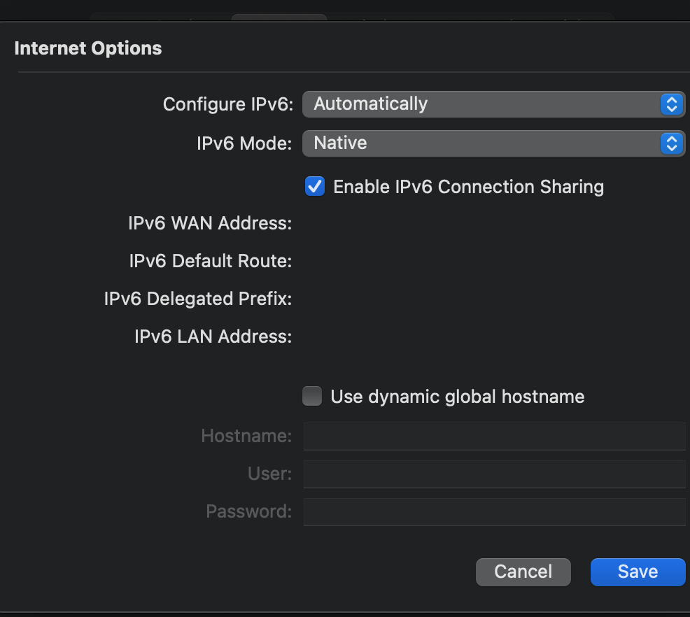

I am using DHCP in the Internet tab. Internet options: I have it Configure IPv6 Automatically but I have tried local-link and IPv6 Mode Native: it is set to Native.

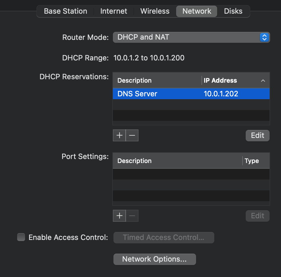

In the Network tab I use DHCP and Nat. I use DHCP Reservations for several of the machines needing a Static IP. Then under Internet Options: Enable NAT Port Mapping Protocol. Enable IGMP and Block incoming IPv6 connections is off.
