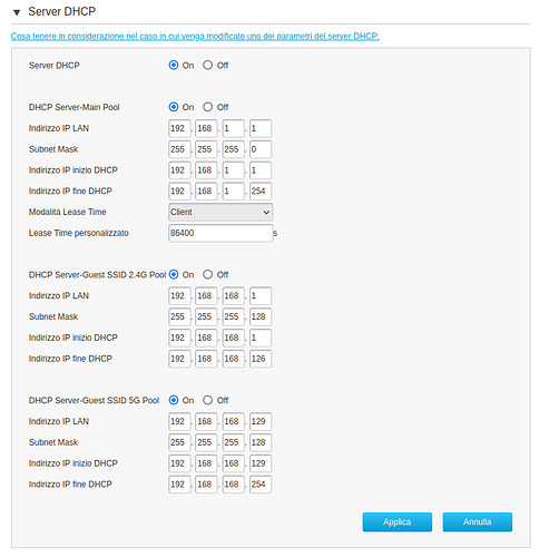

This is the section for DHCP server on my router.
Whitch parameter I should modify?
Those are all the settings for the IP address range and lease time. Is there any section for DHCP DNS, maybe another tab or Advanced section or something like that?
It might be that this router defaults to using itself for DNS and there is no way to change this.
