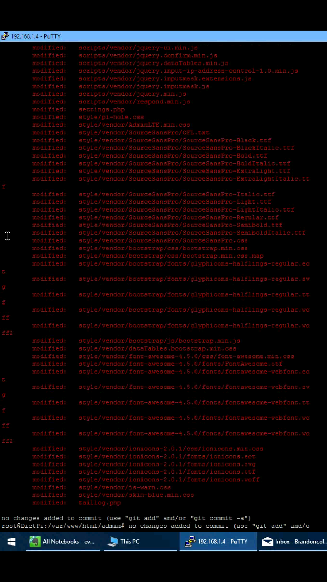

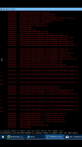

Not sure what to look for. Does this help?
Also, to clarify, I have not intentionally made any changes to the area you mentioned. Could it be because I used DietPi to install?
Or would it be easier to do a 'clean' install? Start from scratch?
DietPi should have used the Pi-hole installer, but it does some changes with lighttpd.conf. I wouldn't expect for that many files to show as being modified. Could you check with fourdee and see if he's seen anything like this in his installer process? That's a lot of modified files from the standard installation. I normally would say at this point to delete the /var/www/html/admin directory and clone in a new copy, but I don't know if that would cause a break in DietPi?
