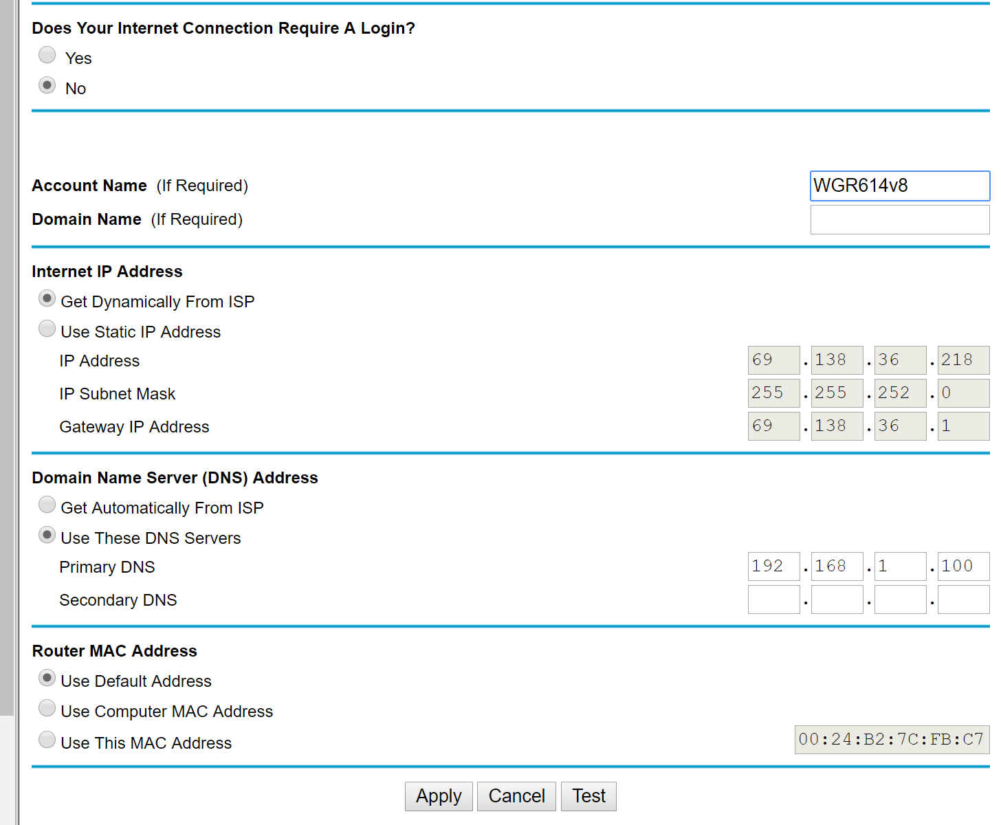

I have a windows laptop that is on a WiFi network. So I toggled airplane mode to simulate disconnecting the cable. But going through the ipconfig steps did not show that 192.168.2.100(that's what I set) was the DNS. This is the WAN adapter's settings:
Default Gateway . . . . . . . . . : 192.168.1.1
DHCP Server . . . . . . . . . . . : 192.168.1.1
DHCPv6 IAID . . . . . . . . . . . : 77094867
DHCPv6 Client DUID. . . . . . . . : 00-01-00-01-20-91-EA-A2-98-5F-D3-EC-94-60
DNS Servers . . . . . . . . . . . : 192.168.1.1
The Pi Hole is only blocking ads on the .1.1 client. However, my laptop doe s seem to be seeing the effects of it. When I visit sites (say Slack) I see it immediately being allowed in the query log.
Now, I could go into Network & Sharing under Control Panel, and change the IPv4 properties to use the .1.100 as the DNS, but I thought I didn't have to manually do it for each device.

You need to change dns server in the dhcp server settings in your router. So NOT in Pihole admin page.
You changed the connection settings ...ie. how your router connects to the internet.

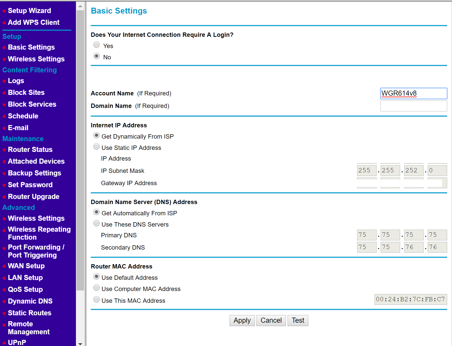

Set back the dns from isp.

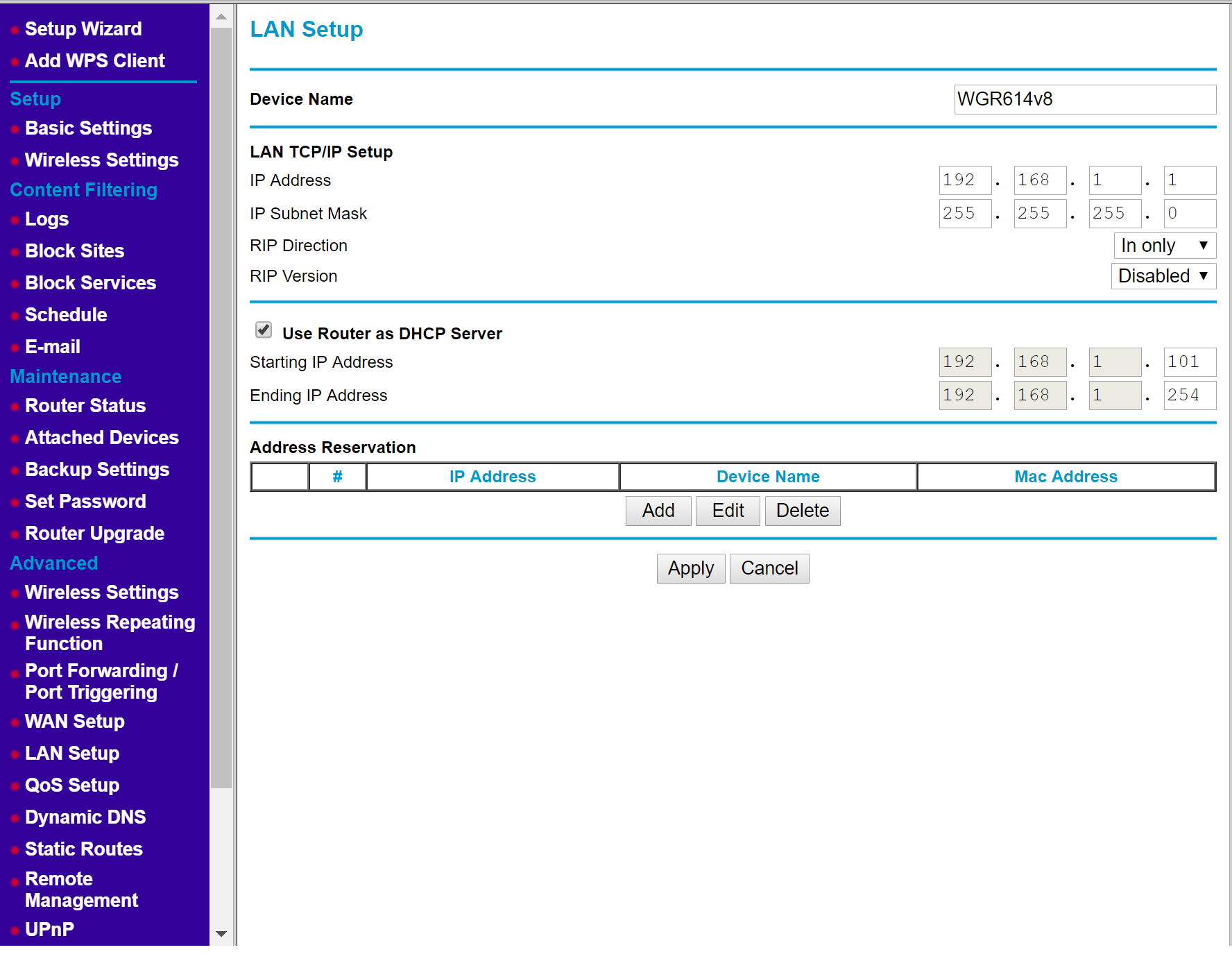

Find the dhcp settings on your router probably under a tab called lan.

If you ever find the DHCP server settings on your router, make sure the range starts with 192.168.1.101 as you made pihole 192.168.1.100.
I couldn't reach my router last night through the browser. So I reset it. And I added my devices back first. Since I thought they'd be given IPs starting from 2 onward I decided to set the Pi to 100. I think I just understood what's happening given that my laptop got assigned .105.
Reverted Basic Setting's to automatic for DNS
Changed DHCP server to start from .101

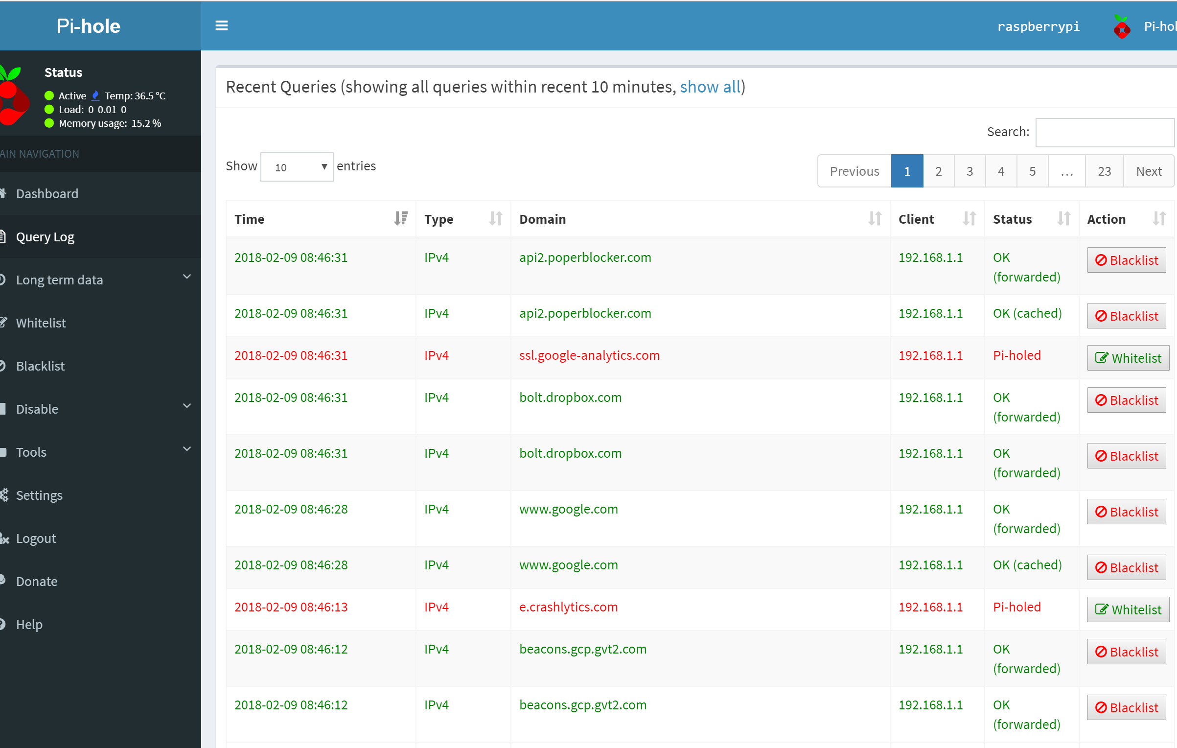

This is the Pi hole admin page
When you were giving the initial set of instructions, you asked me to set the DNS range to start from .6 (when the Pi was .6). Now that it is 100, shouldn't it start from .100 too?
No, as you have set your pihole to 192.168.1.100 dchp should not assign some other device 192.168.1.100.
DNS is NOT DHCP.
DHCP has a range of adresses that will be assigned to end clients

Looking at the screenshots... draytec router?
Remember correctly you can not set the DNS in lan settings in draytec.
Have to send you back to the DNS of the isp. change that to 192.168.1.100
Like you did.
Pihole will work, but your admin page will only show requests from 192.168.1.1
As the draytec will do the request for the pc's/mobile.
Some sites mention you can set the lan dns settings in "applications" on the left menu of the draytec
But first lets keep it like it is now.

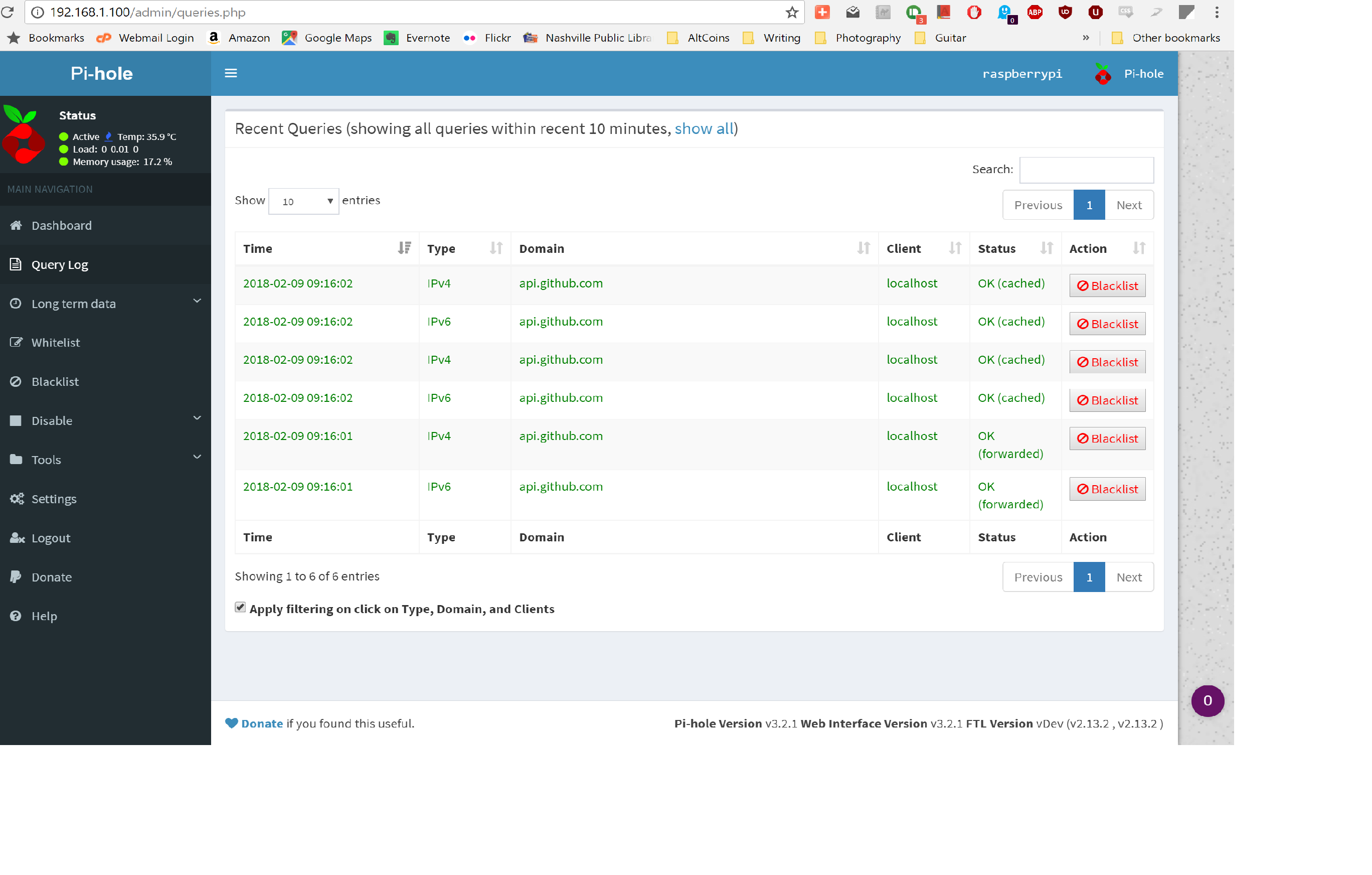

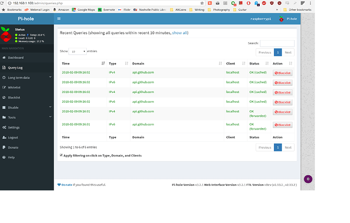

As a test:
add domain piholetest.com to the blacklist of the pi.
On a pc: ping piholetest.com
The reply should be 192.168.1.100
piholetest.com was successful.
