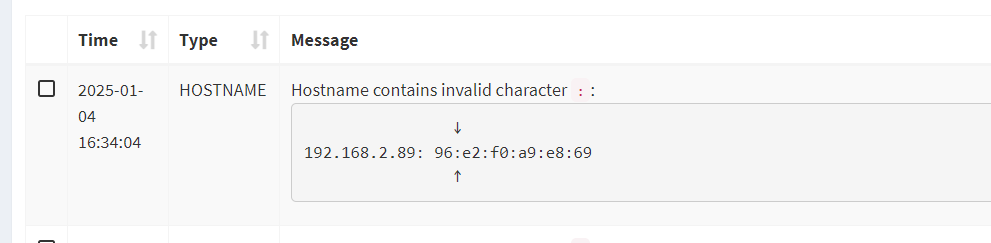

Warning of invalid hostnames due to colon in MAC addresses?
Pi-Hole should recognize MAC address hostnames as valid, including the colons that are part of those hostnames.
Pi-Hole DHCP is issuing warnings that hostnames have invalid characters when (to my limited understanding) the invalid characters are colons that are part of the hostnames:
I'm getting multiple of these. Once I see the warning, I can't find the corresponding IP address or hostname in the DHCP leases.
I'm not sure if this is of great concern or not.
https://tricorder.pi-hole.net/YIVz3fdz/
This is correct.
Valid hostnames contain only letters (a to z), digits (0 to 9), and hyphens (- except as the first character).
You are trying to enter an invalid hostname.
96:e2:f0:a9:e8:69 is a MAC address, but not a valid hostname.

Isnt it the IP 192.168.2.89 from the screenshot above?
If its a MAC for a hostname:
It's also be a randomized MAC. Media Access Control (MAC) address randomization is a privacy technique whereby mobile devices rotate through random hardware addresses in order to prevent observers from singling out their traffic or physical location from other nearby devices.
Most likely candidate is a phone or maybe even a pad thats advertising its MAC address as a hostname when it negotiates a DHCP lease from Pi-hole.

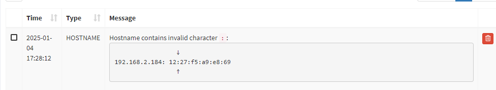

So (apologies if I'm pulling this too far off topic), is there a way to figure out what the device is from the Pi-Hole end? I'm not very experienced with these things, but if it's connected to my wifi, is there a way to see what it's sending to and getting back from the network?
Here's a recent invalid hostname (which I now understand != the MAC address, thank you!):
I can see it in the DHCP table as "unknown":
...is there a way to see what it's doing on the network so I can deduce what device it is?
The device is 192.168.2.184 (that's the device IP).
As you already said, Pi-hole is not receiving a hostname (showed as "unknown").
I'm not sure where this hostname comes from. Probably from the device itself.

Both your logs show warnings like:
[2025-01-04 20:46:06.073 49387/T49424] HOSTNAME WARNING: Host name of client "192.168.2.184" => "12:27:f5:a9:e8:69" contains (at least) one invalid character at position 2
[2025-01-04 20:46:06.093 49387/T49424] INFO: FTL replaced 2 invalid characters with ~ in the query "[invalid~host~name]"
Note that this is just a warning saying Pi-hole received a hostname containing invalid characters. This is not a Pi-hole error and nothing is broken.
I guess the phones are using the fake MAC addresses as names. Check your phone settings and see if you can change the names avoiding invalid character (spaces, accented characters, etc).
