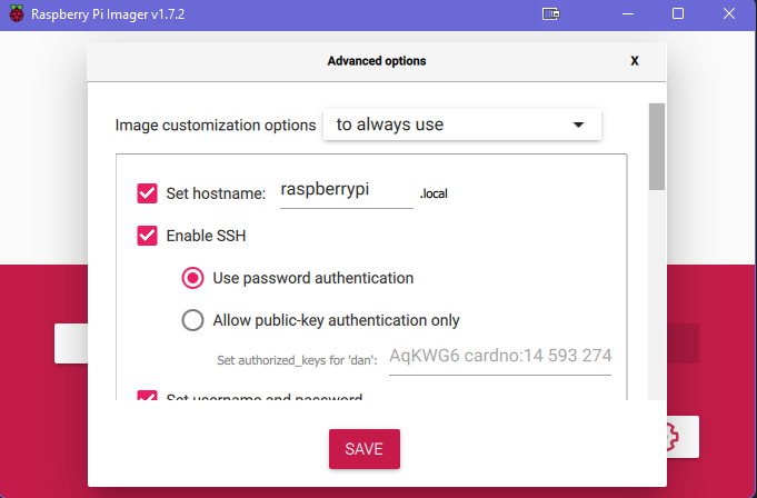

Nice, even a public key can be added via imager. Would be nice to have a way doing that just by placing/editing a file in boot filesystem to not depend on the imager or a GUI in general, but usually that is not an issue.
Isn't that what I did in the first post of this topic?
I use (since forever) SD card Formatter and WinDiskImager. After the write has completed, I simply drag/drop the required files on the SD card, eject, done.
You created the pi user with password, but not the public SSH authentication key (for passwordless and safer SSH authentication), or did I overlook something?
Nope, correct, haven't investigated that option, however,
I assume Raspberry Pi Imager (a windows app - mac version available) can only write to the fat32 boot partition. Assuming this is correct, it implies a file is added to the boot partition, containing this information, used to create the required files when the system boots for the first time. Simply find the name (documented?) of the file and add it (drag/drop) on the boot partition, before ejecting the SD card.
personally, I copy the required files in the /home/pi/.ssh folder and change the owner and permissions, using script, whenever performing a new install, after first boot.
I was wondering exactly that, since there are no native ext4 drivers for Windows and the 3rd party ones I know are either read-only or using them for writing often destroy the filesystem (when I tested last). A view into the FAT partition after using the imager should give clarification. SD cards here are currently on heavy use, but will do that when I find time.

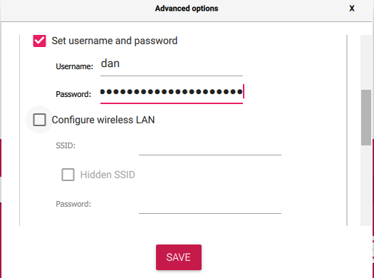

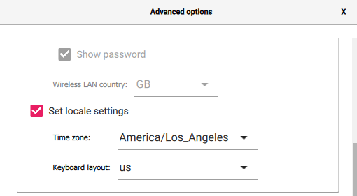

Boot:
firstrun.sh
#!/bin/bash
set +e
CURRENT_HOSTNAME=`cat /etc/hostname | tr -d " \t\n\r"`
echo raspberrypi >/etc/hostname
sed -i "s/127.0.1.1.*$CURRENT_HOSTNAME/127.0.1.1\traspberrypi/g" /etc/hosts
FIRSTUSER=`getent passwd 1000 | cut -d: -f1`
FIRSTUSERHOME=`getent passwd 1000 | cut -d: -f6`
if [ -f /usr/lib/userconf-pi/userconf ]; then
   /usr/lib/userconf-pi/userconf 'dan' '$5$AbMr73TOTV$9.QYdcqu2fqdtmoFvgZ8ZxW71SVt2uyk6uXJ3txMNo1'
else
   echo "$FIRSTUSER:"'$5$AbMr73TOTV$9.QYdcqu2fqdtmoFvgZ8ZxW71SVt2uyk6uXJ3txMNo1' | chpasswd -e
   if [ "$FIRSTUSER" != "dan" ]; then
      usermod -l "dan" "$FIRSTUSER"
      usermod -m -d "/home/dan" "dan"
      groupmod -n "dan" "$FIRSTUSER"
      if grep -q "^autologin-user=" /etc/lightdm/lightdm.conf ; then
         sed /etc/lightdm/lightdm.conf -i -e "s/^autologin-user=.*/autologin-user=dan/"
      fi
      if [ -f /etc/systemd/system/getty@tty1.service.d/autologin.conf ]; then
         sed /etc/systemd/system/getty@tty1.service.d/autologin.conf -i -e "s/$FIRSTUSER/dan/"
      fi
      if [ -f /etc/sudoers.d/010_pi-nopasswd ]; then
         sed -i "s/^$FIRSTUSER /dan /" /etc/sudoers.d/010_pi-nopasswd
      fi
   fi
fi
systemctl enable ssh
rm -f /etc/localtime
echo "America/Los_Angeles" >/etc/timezone
dpkg-reconfigure -f noninteractive tzdata
cat >/etc/default/keyboard <<'KBEOF'
XKBMODEL="pc105"
XKBLAYOUT="us"
XKBVARIANT=""
XKBOPTIONS=""
KBEOF
dpkg-reconfigure -f noninteractive keyboard-configuration
rm -f /boot/firstrun.sh
sed -i 's| systemd.run.*||g' /boot/cmdline.txt
exit 0
cmdline.txt
console=serial0,115200 console=tty1 root=PARTUUID=0ee3e8a8-02 rootfstype=ext4 fsck.repair=yes rootwait quiet init=/usr/lib/raspi-config/init_resize.sh systemd.run=/boot/firstrun.sh systemd.run_success_action=reboot systemd.unit=kernel-command-line.target
Ah of course, with the custom first run script is can all be coded of course :+1:.
That was with password ssh. I'm running one with keys now...
firstrun.sh
#!/bin/bash
set +e
install -o "$FIRSTUSER" -m 700 -d "$FIRSTUSERHOME/.ssh"
install -o "$FIRSTUSER" -m 600 <(printf "ecdsa-sha2-nistp256 <KEY>") "$FIRSTUSERHOME/.ssh/authorized_keys"
echo 'PasswordAuthentication no' >>/etc/ssh/sshd_config
else
      fi
      fi
      fi
   fi
fi
XKBMODEL="pc105"
XKBLAYOUT="us"
XKBVARIANT=""
XKBOPTIONS=""
KBEOF
exit 0
