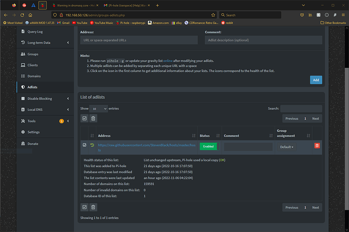

You have no subscribed adlists:
*** [ DIAGNOSING ]: Adlists
Restore at least one adlist, then rebuild gravity.

  • Log in to Pi-hole's web interface
  • Click on Adlists in the sidebar
Do you see your list https://raw.githubusercontent.com/StevenBlack/hosts/master/hosts in the list below? Pi-hole comes with this list included as standard. If you don't see it then you can add it back.
To add it back
  • Just above where it says Add a new adlist, paste in the adlist address and click the Add button and it should now be showing in the list like above
Now you have to tell Pi-hole to inspect that list and extract all the domains from it to store locally in its adblocking database. Pi-hole calls this database Gravity. So you need to update Gravity. To do that
  • Click on Tools then Update Gravity in the sidebar
  • Click the long blue Update button over on the right
It will take a minute or two, so stay on that page until it says it's done. Now you're all done. If you go to the Dashboard in the sidebar you should see the green Domains on Adlists icon at the top now has many thousand domains on it, which all came from that list.
You can add more adlists from other locations, but don't forget to Update Gravity if you add a new list.

Take this URL
and add it to your adlists in the web Admin GUI. Then rebuild gravity.
the link was there the whole time so i just updated Gravity (for chrisIph) what else can i do now?
