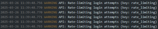

I am seeing this message appear 6x in the FTL.log every 30 seconds>
2025-03-26 11:39:48.756 WARNING API: Rate-limiting login attempts (key: rate_limiting)
2025-03-26 11:39:48.770 WARNING API: Rate-limiting login attempts (key: rate_limiting)
2025-03-26 11:39:48.771 WARNING API: Rate-limiting login attempts (key: rate_limiting)
2025-03-26 11:39:48.790 WARNING API: Rate-limiting login attempts (key: rate_limiting)
2025-03-26 11:39:48.793 WARNING API: Rate-limiting login attempts (key: rate_limiting)

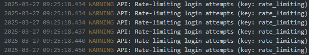

I've discovered this is not an issue originating from Pi-Hole, but caused by a number of command line switches I've configured in Home Assistant, as detailed below.
But is there any way to alter the rate limits for API login? I understand they're probably in place for security purposes.
