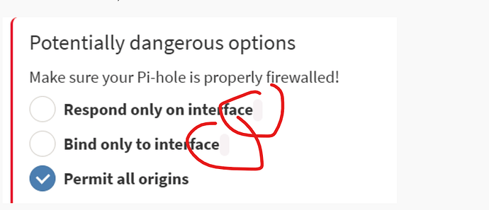

Dunno if it's relevant, but I also see that the device name here is blank for some reason:

The missing interface name not displaying is a known bug and a fix is underway. As your local clients can reach the Pi-Hole it is unlikely to be involved.
