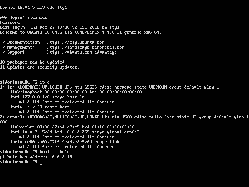

ssh into the Ubuntu platform and run this command: ip a
From the client machine terminal, what is the output of host pi.hole
I'm not sure how to copy paste so I took a screenshot.
Are you able to ping the IP address from the host machine? You may need to set up the VM networking so that it can be accessed from outside machines.
It appears I cannot ping the ip address (10.0.2.15) from the host machine. I am not sure how I would set up the VM networking because if I tinker with the network settings on VirtualBox, I get no connection in my VM. I am using a wireless connection for reference. I apologize if this issue is out of your area of support.
