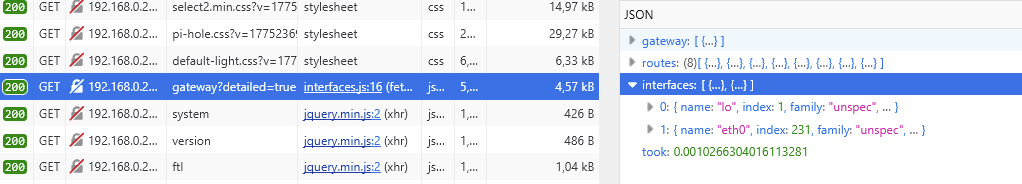

Can you please check the web interface using the Devtools?
Please open the Tools > Interfaces page with the devtools opened, then select the "Network" tab and reload the page. Look for gateway?detailed=true file and look for the "Response", on the right side:
Note: The screenshot above is from Firefox. This will look different and use slightly different descriptions on different browsers.
How many interfaces appear on the response?
(I expect to see the same returned on the command line)
